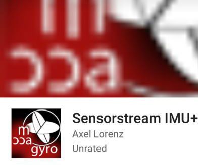

The app can be found on the Google Play app store.
To download: Search ‘IMU GPS’ from the homescreen of the Google Play application and choose the ‘Sensorstream IMU+GPS’ result (shown in the first image above as the third search result).
The application may take a few minutes depending on connection speeds. Once the application is downloaded it can be found in the ‘applications’ folder on the device you are using.
