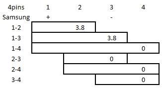

Since no batteries are involved, on the back of the phones I soldered the “red” to the plus and “black” to the minus. The other 1, 2 or 3 middle pins I found them irrelevant, you can search on the internet
4th picture is showing pin configuration on a typically Samsung 4 pin battery. Basically Pin 1 is positive, Pin 2 & 3 are negative, and pin 4 is for temperature sensor, so not need it. The soldering for power should be done for Pin 1 & Pin 2 (not recommend it since it is too close and can short out) or Pin 1 and Pin 3 (recommend it since they are far apart, also better use hot glue). In case of non standard battery, as a rule of thumb, better solder between pins who have a voltage of 3.7-4.2 V if finding the pins is too difficult.
