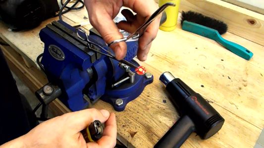

Step 1: Step:1 Choose Your LED and MCPCB.
For this tutorial we are going to use Cree XHP-70s, Cree XM-L2s and copper direct thermal path MCPCB. The XHPs will go on a SinkPad, and the XML2 on a noctigon.
Step 2: Step 2: Next Choose a Heat Source.
A few good options are.
1. An electric skillet ( my favorite)
2. A propane torch and a metal base
3. A heat gun
4. A lighter
Step 3: Step 3: Adding the Solder
The best thing to use is solder paste. However if you don't have any you can just tin the pads of the mcpcb with lead tin solder. Some flux is recommended if you do.
Step 4: Step 4: Placing the LED
With the solder in place we need to check the direction the LEDs need to go on. Each LED will have its own indicator which can be found on its PDF data sheet on the web.
The XHP-70 has a "T" shaped arrow on the bottom that points toward the positive side of the MCPCB. The XML2 has a black dot in the top right hand corner that indicates negative.
Once that is done simply place your emitter on the board over the solder and your ready to go.
Now apply heat to the base of the LED star (mcpcb) till the solder melts. Bring the heat up gradually. Its best if the warm up takes at least 10-20 seconds from start to melt.
Step 5: Step 5: Make It Even
Once the solder has melted the LED will slide into place. When it does you will want to slide the emitter from side to side using a pair of hemos or pliers to make sure the solder is spread evenly between all the pads.
Step 6: Step 6: Remove the Extra Solder
Once the solder is spread evenly you will want to "tap" on the dome of the emitter to squish out the extra solder.
Step 7: Step 7: Check Your Work
Using a DMM set to the continuity setting you can touch the leads to a 3 volt LED like XML and it will light up if you have done it correctly. 6V emitters will require a bench supply or battery pack for the test as DMM leads will not have enough voltage.
