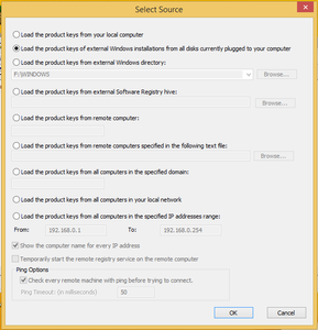

Saving product keys for Windows and other software

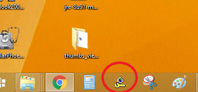

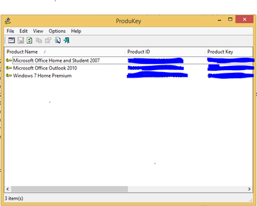

If there is information than needs to be saved it is crucial to backup the important files on the computer. Some software often requires product keys to reinstall such as Windows or Office. Using the program Produkey saving this info is quick and easy if there isn't already a physical key available. On Windows 8/.1 and 10 this is the only way that I know of to save the product keys for installation.Make sure this is done if possible.

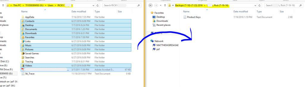

Backing up user data (Pictures, Music, Documents, Videos, Favorites, Emails)
To backup files you can plug in a external storage device (bigger is better) or you can remove the HDD entirely and use a SATA dock to backup to another computer. Most of the user data is in this directory...
There are hidden folders that programs use to store user data. To view them you must enable hidden folders.
C:\Users\"USERNAME"
If there are multiple users then you should create separate folders on the backup location so the personal information is not mixed.
1: Open User directory you wish to backup
2: Click/drag or Copy Paste to the external backup device

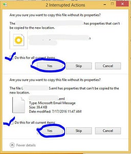

3: Wait until transfer is completed. If a message pops up stalling the transfer check the box that said "Do this for all" Most of the time yes is the safest answer. If you get a message saying the file name is too long just check skip of change the name to the file later.
4: Finally after all the data is saved to a removable device and has completed you may disconnect it, and begin the RFRL process.

  • If your backup is halted with a message as shown generally checking the box and saying yes is the best solution.

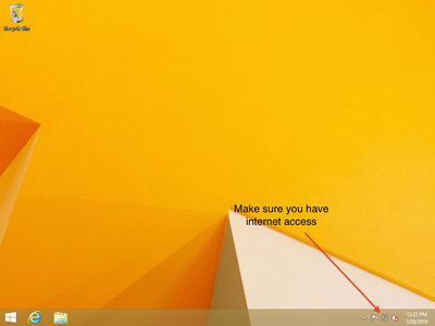

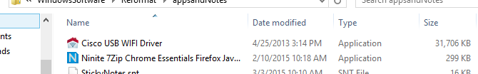

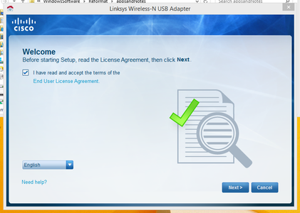

Once you have the os opened it's all down hill from here. Check your internet connection if none is available most likely drivers are missing. Driver software can be found at the manufactures website... but whats that your ethernet and wifi driver aren't installed to access the internet? Don't panic you can always use a USB WIFI adaptor! Or if you have another Computer you can download the drivers and move them to the computer in need via USB or CD. If you don't have another PC then I don't know how you are reading this.
(OPTION) Instal the USB WIFI CARD
Usually this will be provided with the card itself on disk. Once connection is established you may proceed.

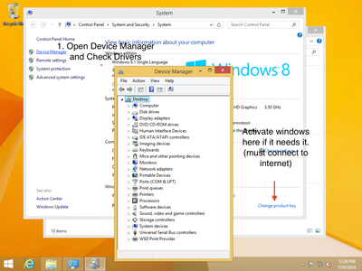

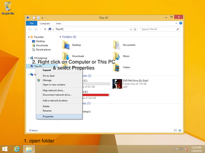

1: Go to device manager and see the what drivers need to be installed. Open file explorer and right click on Computer/ThisPC then go to the bottom option Properties. Device manager is on the top left hand corner.
2: Devices listed with an yellow ! mark are missing. Sometimes Display and audio drivers need to be updated even if there isn't a ! indicating they are missing. this is because windows has a "one size fits all" basic driver for these that it uses.
3: Google search the Manufactures Support site. or follow these links DellHPASUSLENOVOACER
4: Enter your PCs model number and Download and instal each driver you need. Instal each driver after you are done reboot the PC.
