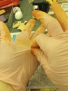

Step 2: Pinch the Palm
Using your primary hand, pinch the glove in the palm area of your other hand.

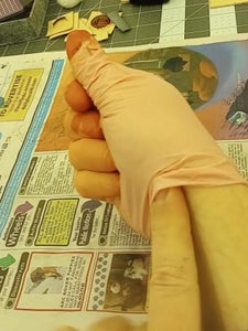

Step 4: Crumple
Using just the fingers of your still-gloved hand, crumple the removed glove into your palm.

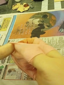

Step 5: Insert Finger
Slide your free index finger underneath the cuff of the remaining glove. Rotate the index finger so it resembles a hook.

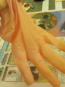

Step 6: Peel Off the Glove
Using this hook, pull the remaining glove up toward the fingers. The crumpled glove should end up inside the this glove.
Step 7: Properly Dispose
You now have one glove inside an inside-out glove. All contaminated surfaces are inside this protective cocoon. Dispose of it as needed (bio-hazard or sharps bin for medical, waste basket for leather dye).
