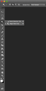

Step 4: Select the Magic Wand Tool on the Vertical Toolbar
On the left vertical toolbar, right click the fourth icon from the top (wand icon) and select the Magic Wand Tool.

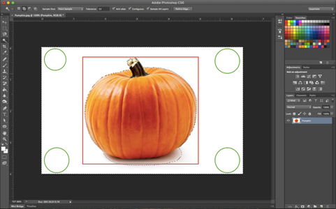

Step 6: Make Your Initial Background Selection With the Magic Wand Tool
To accurately select your background, CLICK a portion of the background FAR from your object to make your initial selection. You should see animated dotted lines indicating your selection (see figure above). You should only need to click once to select a good portion of your background.
If you have selected your entire object or only a small portion of your background, press Control (Ctrl)+D (Windows), Command (⌘ Cmd)+D (Mac) to deselect and try again.
If you have selected most of your background, proceed to Step 7.
Best practices: As demonstrated in the figure above, CLICK within the GREEN CIRCLES to ensure a GOOD selection that does not overlap your object.
Worst Practices: Do NOT click within the RED BOX as this includes shadows, uneven backgrounds, and your object.
NOTE: You do not need to select the entire background on your first click, and it is ok to have small parts of your object selected.

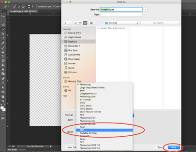

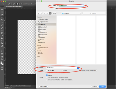

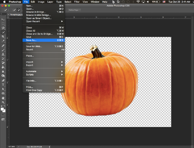

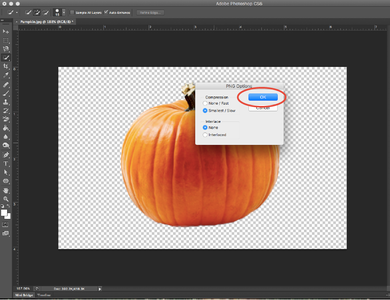

Step 11: Save Your Image As a PNG File
In the Menu bar, hover over FILE and click SAVE AS. If you’d like, change the name of your file, then click the FORMAT dropdown menu. Change your format to PNG. When presented with PNG Options, click OK.

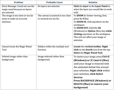

Step 13: Troubleshooting
Having trouble? Here’s a guide to some frequently encountered problems.
