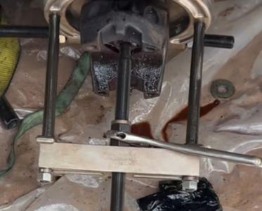

Step 1:
Thoroughly lubricate all bolts; Place bearing splitter around the yoke and tighten it securely with nuts to clamp down
Step 2:
Screw the push puller into the bearing splitter and tighten metal braces against cross member.

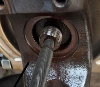

Step 3:
Screw the main bolt into the center of the driveshaft.
Step 4:
Tighten the nut on the crossmember of the push pull and place a crescent wrench to keep its leverage against it.
Step 5:
Turn outside nut with second crescent wrench until yoke is loosen.
Step 6:
If too difficult to turn with hand strength get someone to use leg strength as you hold the second from slipping off.
