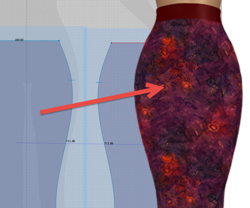

Below are some image captures showing how to export Marvelous Designer clothing to Keyshot and how to hide the avatar.
Step 2: Exporting Marvelous Designer Clothes to Render in Keyshot
Before you export your Marvelous Designer clothing you must make sure that you have named all the patterns correctly. You can either rename the pattern pieces from the 'Scene' tab, or simply click on a pattern and then give it an easy to understand name.
Step 3: Marvelous Designer Clothing Model Export Settings
When exporting your Marvelous Designer clothing model, make sure to select all patterns. You can either export it with or without the avatar. If you have any stitches, text, logos or 2D graphics on your clothes you will want to select all 2D graphics as well when you export your 3D clothes OBJ.
Make sure to remeber what units you export your model (cm, mm, m etc).
If you applied any other color over your Fabric textures in Marvelous Designer, then you will want to check the box that says 'Export with Textures' AND the box that says 'Diffuse Color Combined on Texture'.
