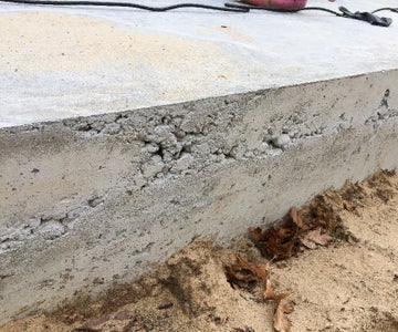

Hey everyone, welcome to Homes for Beginner where I show you how to do repairs around the house yourself. In this video I will be showing you how to patch honeycombing or holes in concrete. We recently had this concrete pad poured for a garage and sadly the contractor wasn’t as much of a professional as they described themselves to be. Honeycombing is caused by improper vibration of the concrete, a dry mixture, or the concrete setting up too fast.

Step 1: Before the Repair
Parging is certainly an option, however it’s a more costly route if you are unable to do it yourself.
As you can see there are quite a few spots that need to be repaired, some of the sides of the pad will be exposed and this isn’t the nicest to look at. This is an example of an aesthetic issue. In an extreme situation where any reinforcement is exposed, this would jeopardize the concrete structure and cannot be properly repaired using this method.

The pad is only a few days old, so I’d like to do this while the concrete is green to help promote adhesion. If you have older concrete where there’s surface damage or spalling, then you’ll need to chisel out or use an angle grinder to remove any loose concrete for a good base for bonding.
Ensure the pad is dry and hasn’t rained recently. Clean the affected areas using a wire brush and a vacuum. The vacuum helps collect the debris as it’s loosened up. Loose debris may prevent the filler from fully adhering to the pockets. Any loose debris which falls out when applying the filler may also cause finish issues.
Compressed air can also be used to clean any debris out of the pockets, this helps remove any sand which may have fallen into these areas too.

Using the putty knife, apply and force the cement mixture into the honeycombing and pockets. This will ensure it’s filled, when the mixture expands, it’s lock in place.
Only apply a small amount at a time, so you don’t have excessive amounts falling on the ground as waste. Try to do this as quickly as possible, this type of mixture does set up quickly. I’m working in about 2 to 3 foot sections to not get too far ahead of myself. This mixture sets up in about 10 minutes so my work time window is fairly small. Once that mixture sets up, it can no longer be used for repairs.
Once it’s in place, using the trowel, smoothing out the repair. I have applied water to the trowel to help smoothen out the surface and prevent the cement mixture from sticking. With the wet trowel, you can work the mixture across the surface, filling in any missed spots. While the repair looks darker at the moment, once it dries and the water evaporates, it’ll lighten up in color.
In the last photo, the repair to the right was done less than 24hrs about. This mixture takes about 28 days to achieve its full strength.
