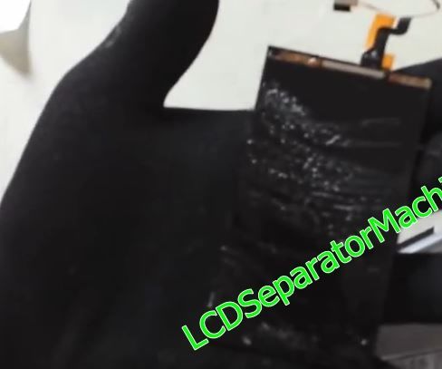

Step 2: Double Check
Make sure the lcd is free of any dust and figure prints. I assume you already have removed the old loca glue.
