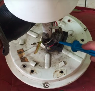

Step 1: Removing the Cover
First, remove the fan blade.
Then, remove the plastic cover by unscrew the outer most three philips screw.
It will expose the rotor winding enclosed by an iron cage.

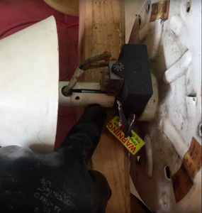

Next would be to remove the electrical component.
The rotor is then rest above the ground to remove the bolt connecting the rod with the rotor.
Remaining capacitor and terminal block could be removed easily.

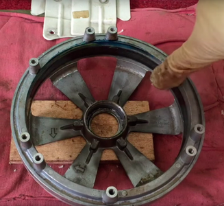

Step 2: Removing the Back Plate
Once all component removed, the back plate could be remove easily.
A tap might be required by turning it up site down and giving it a gently push downward.

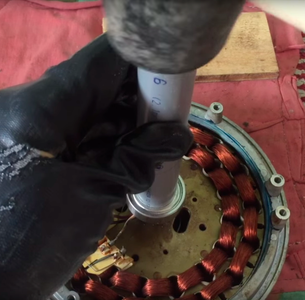

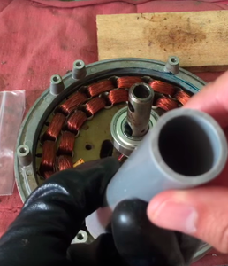

Step 5: Installing the New Bearing

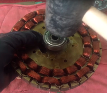

The new bearing according to the serial number printed at the brim of the bearing is place onto the shaft.
A PVC tube with inner diameter slightly bigger than the shaft is used to slot in the bearing into position.
Rubber mallet is used to knock onto the PVC tube.

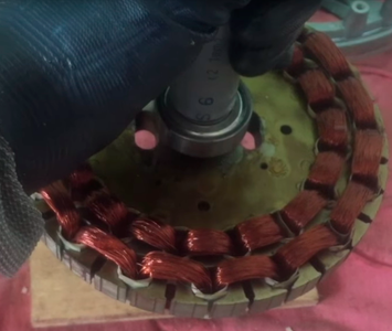

The another new bearing is also install by first knocking it back into the front until it is flatten.
The PVC tube is used to give it a final push. It is optional, Lock tight could be applied prior to the installation.

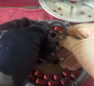

The iron cage housing is being grease using Silicone grease.
Be sure not to forget the washer !
