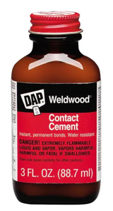

  2. Contact cement similar to this:
  3. https://www.homedepot.com/p/DAP-Weldwood-3-fl-oz-Original-Contact-Cement-00107/100195615

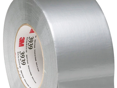

  5. Duct tape

  1. Duct tape one side loosely attaching the 2 pieces
  2. Turn over and brush cement on both sides of the break.

  1. Brush extra cement on top of the cloth..

  1. Remove duct tape
  2. Brush cement on the other side of the watchband
  3. Place cloth on it
  4. Brush additional cement on top of cloth.

Step 4: Duct Tape Back
  1. Place duct tape on the back of the watch band where it touches the skin. If you don't, it will cause a rash where the plastic cement touches the skin.
