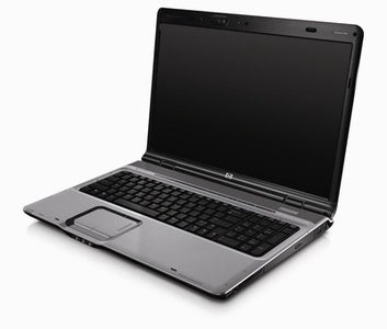

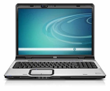

I received an HP DV9260US laptop as a high school graduation present. It worked well until 13 months after I received it, one month after the warranty ran out. To have it commercially repaired would cost on the order of $800, about the cost of a replacement laptop. As such, I decided to repair it myself. When one knows how to repair it, it is not that difficult of a task. The only part that could cause real problems is the problem of organizing the parts and screws. The organizational system I used was to place all the parts and hardware in a labeled ziploc bag whenever a part was removed from the laptop. As there are over one hundred screws, an organization system is critical.
Step 1: Symptoms
The symptoms I ran into were indicative of a video chip failure. My laptop became increasingly unreliable, and I ran into strange visual artifacts, such as flickering, oddly colored horizontal lines on the screen. After about two weeks of this, it refused to start up Windows at all. Another symptom is that it got very hot, even more than it used to, and this series of laptop is infamous for overheating. What was happening, I have since learned, is that the cooling system had become somewhat clogged with dust, and so was unable to cool the video chip adequately. This video chip, as well, was designed such that it has only a minimal tolerance to overheating. This confluence of variables led to the video chip being permanently destroyed.

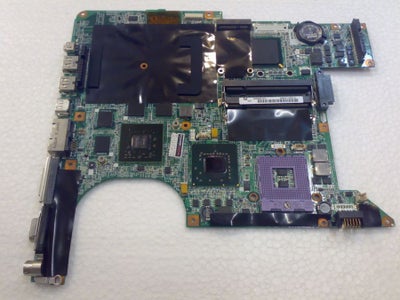

Odds are what needs to be done to repair an HP DV9000 laptop is to replace the motherboard. There are many ways to have it done professionally, but between the material and labor costs they will charge about the cost of a new laptop. As such, it made more sense to me to repair it myself. To replace the motherboard, you'll only need a replacement motherboard, some basic tools, and a repair guide. Everyone will tell you that it is impossible for someone who is not an expert to replace a motherboard, which is patently untrue. It is completely possible for anyone with basic mechanical skills to replace a laptop motherboard. The only thing you need to do is be careful to organize all the parts and screws removed. What I did is label a new Ziploc bag for each part removed, and place the part and screws associated with that part in the corresponding Ziploc bag. The one thing that is most important when replacing the motherboard, however, is having a guide that walks you through it, step by step. Luckily, HP has posted their repair and maintenance guide for the HP DV9000 series of laptops. It can be found here: http://h10032.www1.hp.com/ctg/Manual/c01311536.pdf
Step 4: My Process
There are essentially two ways to replace the motherboard: simply replace it, leaving the cooling system the way it is, or improve the cooling system to perform better. New motherboards don't come with a cooling system, a CPU, ram, or number of other things, so these need to be transferred from the old motherboard. I chose to improve the cooling system, to ensure that I wouldn't fry another motherboard. In the process of improving the cooling system, I went through a great deal of trial and error. It took me quite a while to improve the cooling system properly. Before I came to a workable solution, I fried two replacement motherboards, and ended up completely disassembling and reassembling my laptop around 20 times. Fortunately, I can explain where I went wrong. If you don't have any experience with thermal grease and heat sinks, I would recommend that you mount the old heat sink stock onto the new motherboard.
