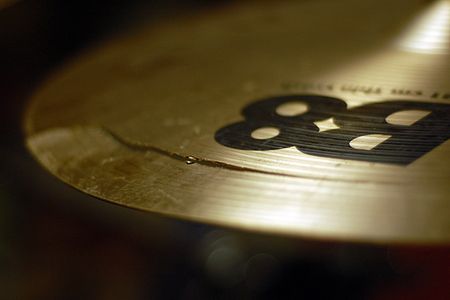

Sorry to say, but once one of your cymbals has cracked, it will never be or sound the same again. Cracks often go unnoticed until they have spread, so the key to keeping your cymbals sounding great (aside from cymbal care) is keeping an eye out for baby cracks.

Here are a few ways that you can attempt to fix the crack(s) in a cymbal. Note: This should be considered a last option, and can further screw up your cymbal.
Using Epoxy:
One of the most commonly suggested methods for repairing a crack is to use epoxy to seal it. Try to force the epoxy into the crack without making too much of a mess. If you get too much extra epoxy on the outside of the crack, just wipe it away with a damp paper towel. After the first application, lightly hit your cymbal with a stick to get the epoxy further into the cymbal. Apply more if necessary. Depending on the type of epoxy you are using, you may have to put it in an oven to dry it, or just let it sit out. Once it is dry, you can polish the cymbal to further reduce the roughness.
My opinion on this method is that it should be used as a last resort. My experiences with using epoxy were mediocre at best, and it pretty much ruined crash cymbals that I tried it on. Give it a shot if you dont want to drill. Otherwise...

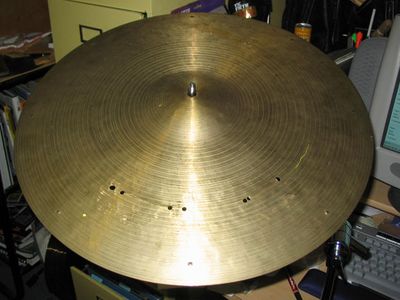

Drill a Hole:
This may be your best bet to fix cracks of all kinds and all sizes. You can drill a hole or holes at the end of your crack to keep it from spreading. Try to use the smallest bit possible, but make sure that the hole is bigger than the width of the crack. Make sure you get a drill bit for metal, like one of these.
Once you have drilled the hole, you may notice a buzzing sound when you strike the cymbal. If this is the case, use a small file to file down the edge of the hole and the crack. Keep in mind, if you are doing this on a lathed cymbal (one the has tonal grooves or ridges on its face), drilling holes on these ridges can obliterate whole ranges of overtones from your cymbal's sound, but sometimes you have no other choice.

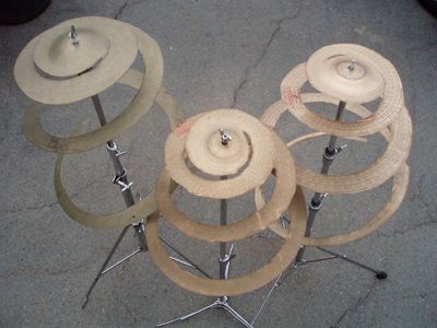

Cut a New Cymbal
If you go to a drum store, you might notice many of the $100 bells that seem to be nothing more than the bell of a cymbal without the bow on it. That is, essentially, what you can make. Using a pair of metal cutters, you can trim down the cymbal until only the bell remains. These actually dont sound half bad, and can make a good combination when stacked with a splash or china cymbal. If you have access to a lathe, you can use it to smoothe out the rough edge of your new bell.
You can also experiment with other designs, cutting your cymbal into various shapes and sizes as you try to find a cool sound. Try making a ribbon cymbal like the ones below by cutting spirally along the bow. Just be careful, the edges of your cut cymbal can be sharp and brittle.

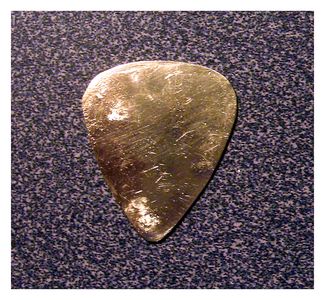

If you try to fix or get creative with your cymbal and you end up just hating the way it comes out, a final option is to use a pair of metal cutters and make a bunch of brass guitar picks. Just use a guitar pick as a sort of stencil and make a bunch to give to your guitarist friends, or even sell them on ebay. Thanks to Quarry for detailing this in his instructable.
