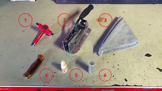

1.    Universal Skate Tool (or 1/2" wrench)
2.    Bearing Press (for Steps 3 and 7 only)
3.    Clean Rag
4.    Pocketknife
5.    Bearing Lubricant
6.    Replacement Bearings (if necessary)

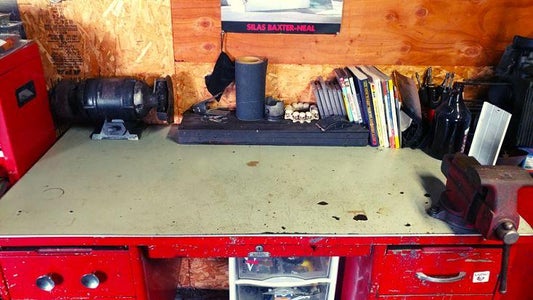

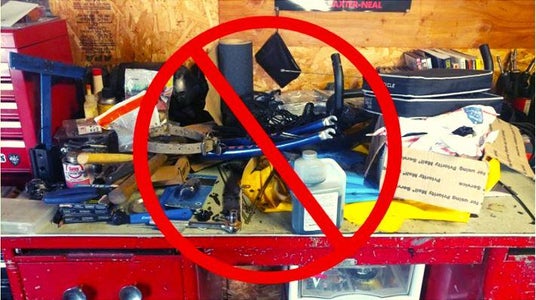

Step 1: Preparing Your Work Area
To Prepare Your Work Area:
  • Put away any tools or parts unnecessary for changing your bearings.
  • Wipe down the work surface.
  • If you're concerned your work area could get damaged by hard tools or scratchy griptape, put down a towel or drop cloth.
Note: A clean work area is a safe work area, so keeping it free of obstructions will make this job easy and keep you healthy.

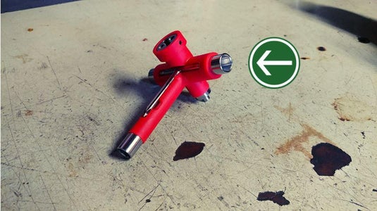

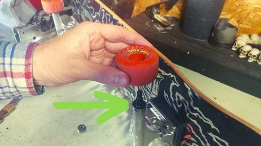

Step 2: Wheel Removal
To Remove Skateboard Wheel from Trucks:
  • Hold skateboard firmly in place on it's side, axles pointing up.
  • Place 1/2" socket of Universal Skate Tool over the hex nut securely.
  • Turn Universal Skate Tool counter-clockwise until Hex Nut is loose enough to be removed by hand.
  • Remove Hex Nut with fingers and set aside.
  • Remove Wheel Washer (outer), Wheel, and Wheel Washer (inner) from axle.
  • Set fasteners and wheel assembly aside for disassembly and cleaning.

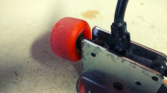

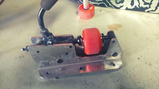

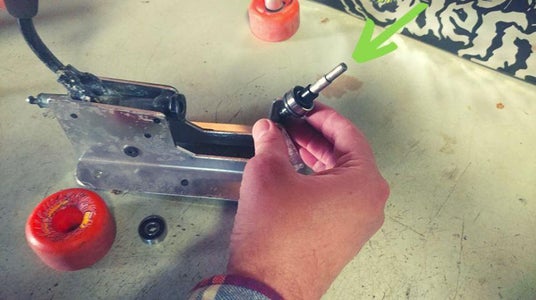

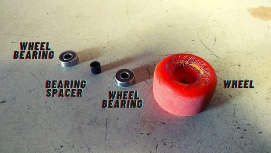

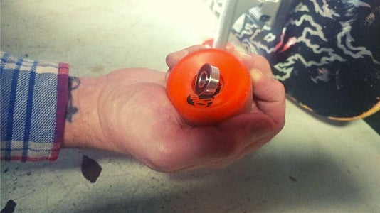

Step 3: Wheel Bearing Removal - With Bearing Press
To remove Wheel Bearings from Wheel:

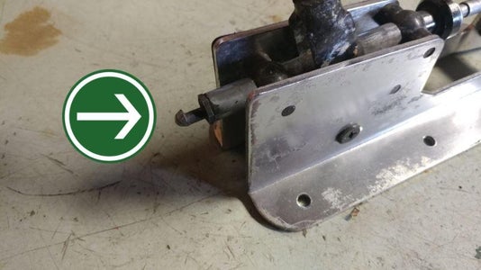

  • Locate bearing removal hook on Bearing Press.
  • Place Wheel Assembly on bearing removal hook.
  • Holding Wheel Assembly with free hand, press down on Bearing Press handle until Wheel Bearing is free of Wheel.
  • Remove and set aside loose Wheel Bearing and Wheel Bearing Spacer.
  • Flip Wheel over and repeat process.

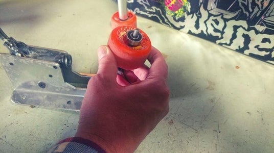

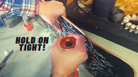

Step 4: Wheel Bearing Removal - Without Bearing Press
To Remove Wheel Bearings without a Bearing Press:
  • With skateboard on its side, axles pointing up, place Wheel about a third of the way onto the truck axle.
  • Tilt wheel until resistance felt, then pry in the same direction until Wheel Bearing is free of Wheel.
  • Remove loose Wheel Bearing and Wheel Bearing Spacer.
  • Flip Wheel and repeat.
  • Set aside loose Wheel Bearings and Wheel Bearing Spacer for disassembly and cleaning.

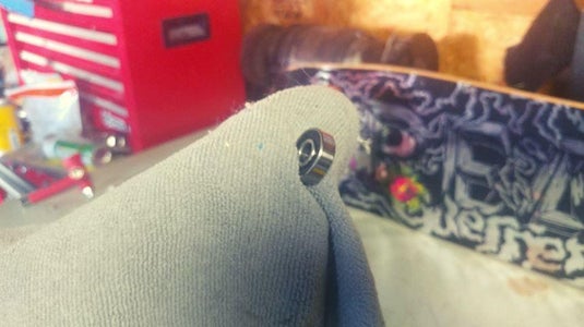

Step 5: Cleaning Wheel Bearings
To Clean Skateboard Wheel Bearings:
  • Inspect Wheel Bearing Shields for tears. If damaged or torn, replace.
  • Determine bearing integrity by spinning Wheel Bearing held between forefinger and thumb. If resistance felt or grinding sound heard when spinning, replace.
  • If Wheel Bearings are not damaged, use Clean Rag to remove dirt, oil, grime from outside.

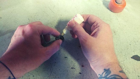

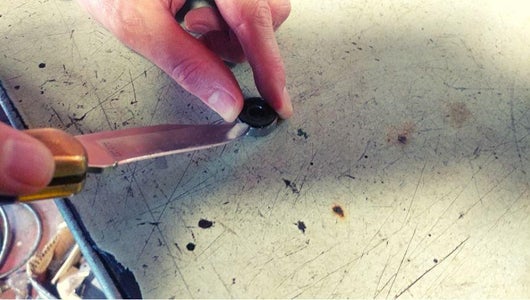

Step 6: Lubrication
To Lubricate Skateboard Wheel Bearings:
  • With Wheel Bearing held firmly in place, slide tip of Pocketknife under rubber edge of Wheel Bearing Shield.
  • Pry up gently, being careful not to cut rubber of Wheel Bearing Shield.
  • Set aside Wheel Bearing Shield.
  • Squeeze two or three drops of Lubricant onto ball bearings inside Wheel Bearing.
  • Replace Wheel Bearing Shields.

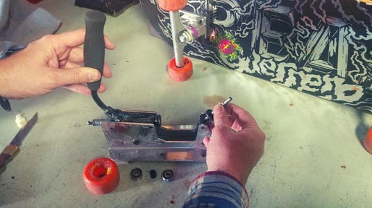

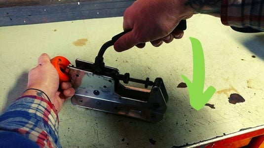

Step 7: Installing Wheel Bearings - With Bearing Press
To Install Wheel Bearings in Wheels with Press:
  • Locate wheel alignment axle on Bearing Press.
  • Slide wheel parts onto vertical wheel alignment axle in the following order; Wheel Bearing (inner), Wheel, Wheel Bearing Spacer, Wheel Bearing (outer).
  • Rotate wheel alignment axle until horizontal.
  • Close Bearing Press handle until Wheel Bearings seat fully in Wheel.
  • Open Bearing Press handle.
  • Remove Wheel Assembly.

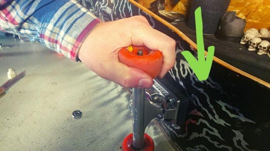

Step 8:
To Install Wheel Bearings without Bearing Press:
  • With skateboard on its side, axles pointing up, slide wheel parts onto axle in the following order: Wheel Bearing (inner), Wheel.
  • Press down firmly with hand on Wheel, rotating to fully seat Wheel Bearing in Wheel.
  • Remove Wheel and Wheel Bearing from axle.
  • Slide remaining wheel parts onto axle in the following order: Wheel Bearing, Wheel Bearing Spacer, Wheel.
  • Remove Wheel assembly to verify Wheel Bearings fully seated in Wheel.
Step 9: Wheel Installation
To Install Wheel Assembly on Trucks:
  • Slide Wheel parts onto axle in the following order: Wheel Washer (inner), Wheel Assembly, Wheel Washer (Outer), Hex Nut (finger-tight).
  • Place 1/2" socket of Universal Skate Tool over Hex Nut securely.
  • Turn Universal Skate Tool clockwise until Hex Nut is tight.
  • Spin Wheel. If Wheel won't spin freely or not at all, turn Hex Nut counter-clockwise until Wheel spins freely.
