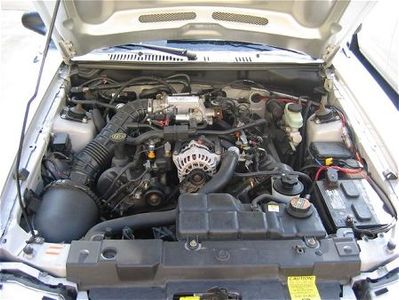

Step 2: Intake Removal
Once each wire has been labeled, your next step is to remove the intake tubing for the air filter and mass airflow sensor in order to access the rear of the passenger side of the engine. This saves you some busted knuckles trying to turn a ratchet in a tight space.This can be done with a flat head screw driver and some patience. Be sure to put a clean rag inside the throttle space in order to keep the intake clean.
Step 3: Wire and Plug Removal/Replacement
The next step in the process is to remove one wire and plug at a time and replace them as you go. Doing this saves you from having to use the firing order diagram that determines the where each wire goes. The wires in the image are highlighted red.

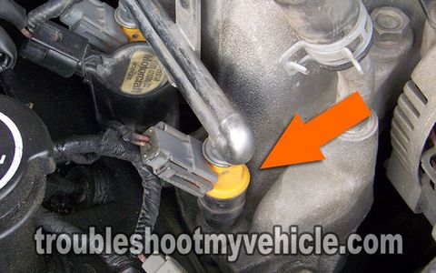

Step 4: Wire Removal
In order to remove a wire on a 1996-98 model mustang as shown, first grip the top of the plug boot, closest to the head in a firm grip. Then with a slight twisting motion and upward pulling motion the plug boot should unseat from the plug intact. Severely damaged or old plug boots may rip. You will need to make sure you remove all of the material from the plug well, to ensure you don't accidentally put any rubber inside the engine.
Step 5: Spark Plug Removal
Next step is to remove the Spark plug from its well. You will need a 3/8 inch ratchet and a 6 inch extension as well as a 3/4 in spark plug socket. Spark plug sockets have a small rubber insert in order to grip the plug as you remove it. The spark plug should be fairly tight as you start. Once you get it started it should come out freely. If you experience any resistance when removing immediately stop and check to see if you are going in the correct direction. if you are then check to see if you are straight on the plug as you can damage the threads within the head of the engine.
