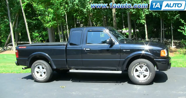

1A Auto shows you how to repair, fix, change or replace a broken or snapped power door lock actuator on 1999-2010 Ford Ranger truck models. The actual vehicle shown is a 2004 Ford Ranger. You will first learn how to remove your existing power door lock actuator, and then how to install a replacement.
