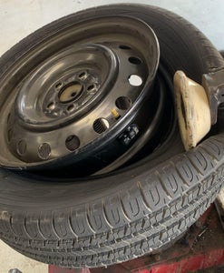

Step 3: Demount the Tire
- Deflate the Tire: Remove the valve core with a valve core removal tool to release the air from the tire.
- Demount the Tire: Use a tire changer machine to carefully demount the tire from the rim or wheel. This exposes the TPMS sensor, which is located at the base of the valve stem inside the wheel.
Step 4: Replace the Tire Pressure Sensor
- Remove the Old TPMS Sensor: Unscrew (usually a T10 torx) or unclip the TPMS sensor from the wheel. Use a valve stem removal tool to pull the valve stem out of the valve stem hole. Take note of its orientation and how it was installed.
- Install the New TPMS Sensor: Pull the new sensor into the valve stem hole using a valve removal tool into the same position as the old one. If it comes with a new valve stem, ensure it's correctly installed. Tighten any screws or nuts to the manufacturer's specified torque.
