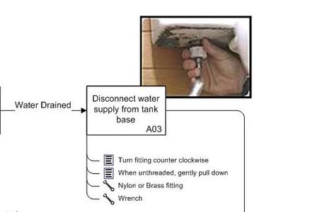

Step 3: Disconnect the Water Supply From the Tank Base
Turn the fitting counter clockwise. When unthreaded, gently pull down on the supply line.
Thing you will need
Nylon or Brass fitting
Wrench
Thing you will need
Wrench
