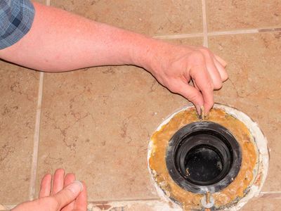

Step 3: Remove the Old Wax Ring
With the toilet removed, you’ll see the old wax ring on the toilet flange. Use a putty knife to scrape away all the old wax from the flange and the base of the toilet. Ensure the area is clean and free of debris.
Step 4: Install the New Wax Ring
Place the new wax ring onto the toilet flange, ensuring it’s centered. Some prefer to attach the wax ring to the bottom of the toilet instead; either method works.
