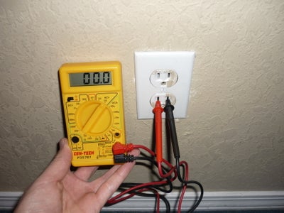

Step 2: Ensure the Power Is OFF to the Outlet
Use a Non Contact Voltage Tester or a Multimeter (Pictured) to ensure that the power is OFF to the outlet.
Important: Check all of the plugs in the outlet you are working on and ensure none of them have power at this point. If any of them are still live (Hot) find the additional breaker(s) and turn them off before continuing. You never know what kind of crazy wiring could be going on inside the wall.
