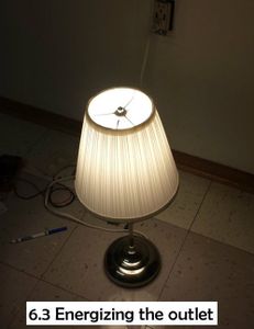

Step 6: Test New Outlet
1. Carefully push the outlet back into the wall, fastening screws to hold in place. Depending on the length and type of wires used, this may require some finagling.
2. Plug in the appliance used in step 1. The appliance should still be set to on, even though no power is applied. This way, as soon as power is restored to the outlet, it will be obvious that the electronic device has become energized.
3. Shut the breaker to the outlet. The appliance should be energized, as seen in image 6.3. If this is the case, the outlet has been wired correctly. If not, there is an issue with one or more of the connections that must be corrected.
DANGER: From this point forward, the outlet is powered, and can pose an electrical hazard. Do not insert objects such as screwdrivers into the outlet, or touch the wires behind the outlet. De-energize the circuit before attempting to make further adjustments to the wires.
