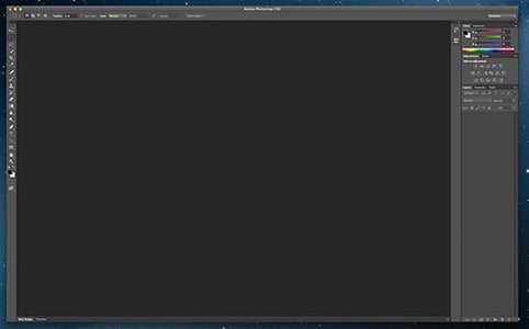

Open Adobe Photoshop, which should look like this.

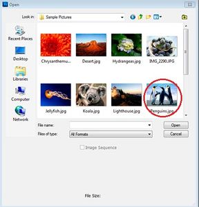

Step 3: Step 3

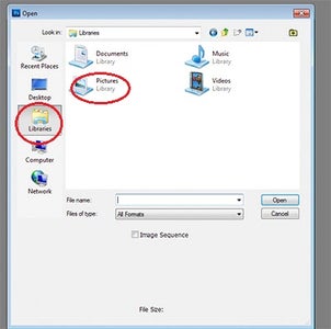

Click ‘Libraries’ and the double-click on ‘Pictures Library’.
Step 4: Step 4
Double-click on ‘Sample Pictures’
Step 5: Step 5
At this point we will be using a sample picture of penguins to illustrate further usage. This is a default picture that comes with all PCs, if you have a Mac do not worry, you may choose any photo of your liking in your photo library. Double click on the penguin picture to select photo and the penguin photo will appear in Photoshop.

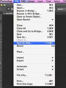

Step 6: Step 6
Go to the menu bar and click on ‘File’ then choose the ‘Save for Web and Devices’ option
Step 7: Step 7
On the ‘Save for Web’ window, check if the present option is set to ‘JPEG High’. If not click the down arrow on the preset option and choose the ‘JPEG High’ option.

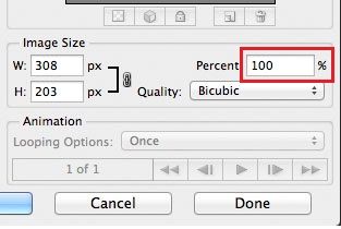

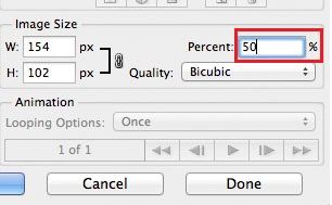

Step 8: Step 8
In the Image Size section of the window, change the percentage setting and press Enter (ex. 100% to 50%)
Step 9: Step 9
Click Save to replace the original image

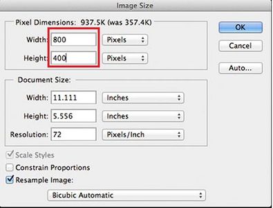

Step 10: Step 1: How to Resize a Photo (Option 2)

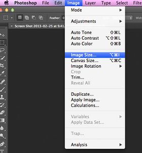

Go to the menu bar and click on ‘Image’ then choose the ‘Image Size’ option.
Step 11: Step 2

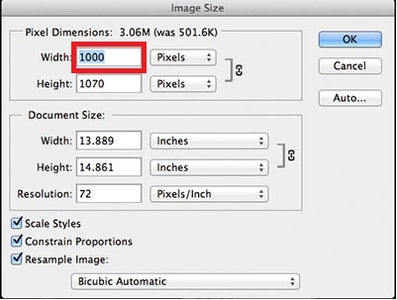

In the Image Size, adjust the pixel dimension by picking either a new width or height (ex. if the width was 1000 pixels change to 800 pixels). When you change one dimension, the other is automatically adjusted.
Step 12: Step 3

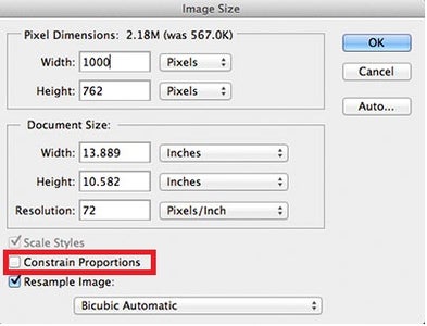

If you want to change both width and height, unclick the ‘Constrain Proportions’ checkbox (The links will go away on the pixel dimensions)
Step 13: Step 4
Change the width to 800 and the height to 400 and then click the OK button. (Note: You will notice that the image is resized, but is distorted. In order to resize the image to these dimensions, we will need to use the crop tool. Before we do that let’s redo out last edit.)

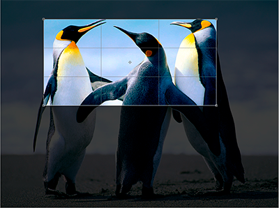

Step 14: Step 1: Cropping a Photo
Click on the Crop Tool.
Step 15: Step 2
Now configure the Crop Tool. Enter 800 for the width and 400 pixels for the height
Step 16: Step 3
Put your cursor over the picture, hold down the left-click and then draw a box around the part of the photo that you would like to keep and then release. (Note: If you make a mistake, you can press the ESC key and start over)

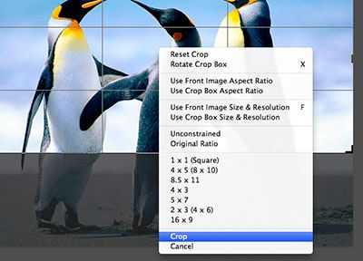

Step 17: Step 4
Right-click inside the box that you drew and choose ‘Crop’. (Note: Now the image is 800 by 400, but now it is not distorted.

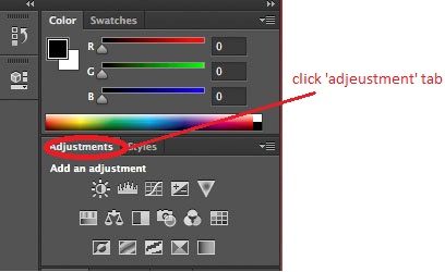

Step 18: Step 1: How to Desaturate a Photo
Click on the Adjustments tab on the right

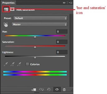

Step 19: Step 2
Click on the Hue/Saturation icon which will give you a second layer over the photo.

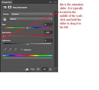

Step 20: Step 3
Hold Left-click on the Saturation slider (the grey triangle) and slide it all the way to the left. This will remove all the color saturation from the photo.

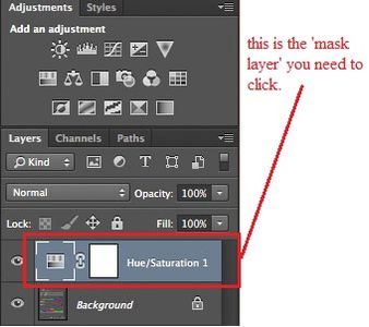

Step 21: Step 4
Click on the Hue/Saturation layer and then click on the layer mask. This is the white square.

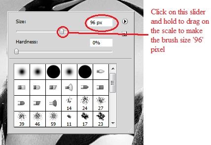

Step 24: Step 7
right click on the image and increase brush size to 96 pixels
