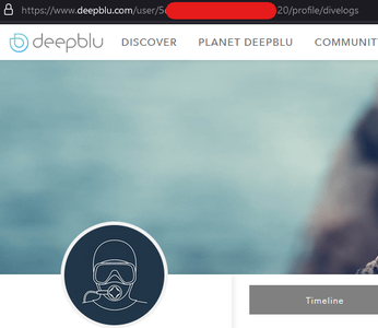

Now you should be on a webpage where you see your dive logs. In the URL of your web browser, you should see something like:
https://www.deepblu.com/user/{user id}/profile/divelogs
{user id} will be a 20-character random string of lower-case letters and numbers, and that is your user id.
Copy your user id somewhere so you can use it again in a moment. The second screenshot for this step shows and example of this, where part of the user id has been concealed for privacy reasons.

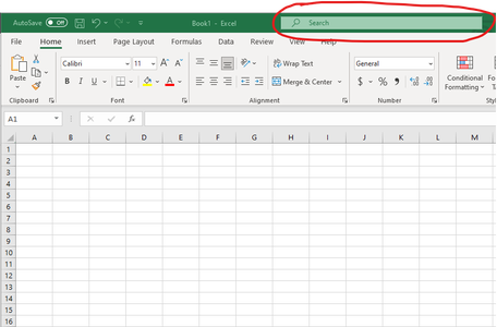

Launch Power Query Editor. There are different ways to do this depending on which version of Excel you have. This tutorial will use Excel for Microsoft 365.
Type "Launch Power Query Editor" into the search bar at the top of Excel to bring up the Power Query Editor application.
