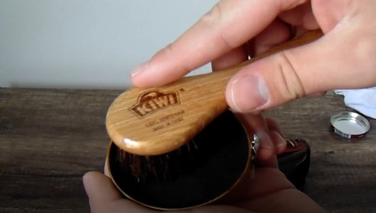

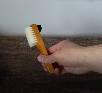

· A cleaning brush with soft to medium bristles (preferably horsehair)

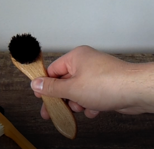

· A dauber brush (preferably horsehair)

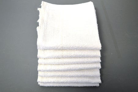

· two washcloths

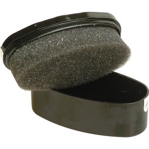

· A shoe sponge

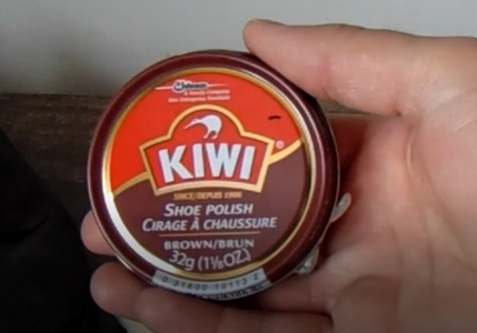

· Paste shoe polish

Many of the items above can be acquired by purchasing a shoe care kit from Amazon, Target, Walmart, etc. The brand of these products absolutely does not matter, however Kiwi is the most popular brand and perhaps the easiest to find. Remember to try to match the color of your polish to the color of your shoes.

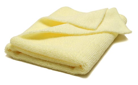

The bristles of the brushes can be made of synthetic materials such as plastic, but it is better to avoid these kinds as they can damage the outer layer of the shoe. For the polishing cloth, it is acceptable to use any smooth fabric such as an old t-shirt or socks. If available, it is recommended to use flannel rather than cotton but never use terrycloth (washcloths, hand towels) as it can remove some of the polish.

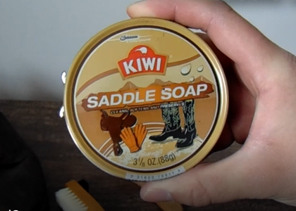

If a shoe sponge is not included in the care kit, you may want to purchase one if it is cheap enough or use a nonabrasive kitchen sponge. Saddle soap is a great choice for cleaning and conditioning the leather on shoes but if you cannot find any, an acceptable alternative would be a heavily oil-based soap or, if necessary, a mild bar soap such as Ivory.

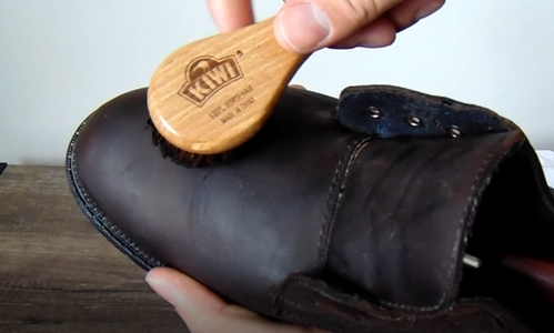

The first step is to remove all of the dust, dirt, and buildup from the exterior of the shoe. Use the larger cleaning brush to thoroughly remove all debris from the outer surface, paying close attention to areas where dirt buildup is most common. Remember to spot check areas with a light colored washcloth to ensure there is no residue left behind.

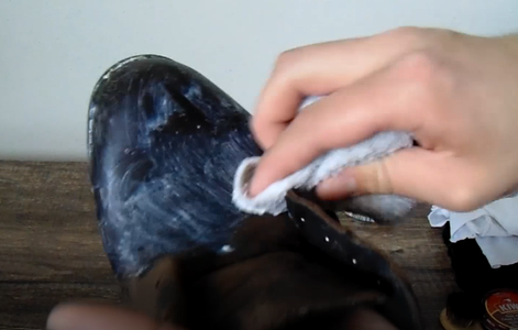

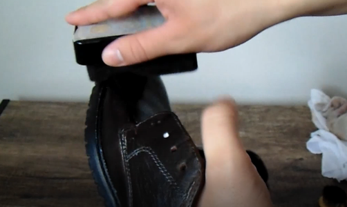

Now we must clean and condition the outer layer of our shoes. Take a damp cloth and work the saddle soap into a rich lather then apply to the outer surface of the shoe. Use small circular motions to ensure proper coverage and repeat the process if necessary. After the saddle soap has been applied, lightly dampen the shoe sponge and gently remove the excess lather. We must allow the shoes time to dry before moving on to the next step, it is recommended to fill the inside of the shoes with newspaper or old t-shirts to help them retain their shape and prevent creases from forming during the drying process.

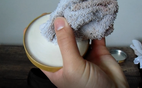

Now take the dauber brush and apply the paste polish to the bristles, remember to dab the brush onto a damp cloth or sponge before applying to the outer surface of the shoe. This allows the polish to blend with the moisture helping us achieve a smoother polish. Use small circular motions to properly cover and blend the polish onto the exterior of the shoe. If you feel an area starting to become rough, use a very small amount of water to reduce friction. Keep building up polish until you have evenly coated the entire outer leather layer of the shoe.

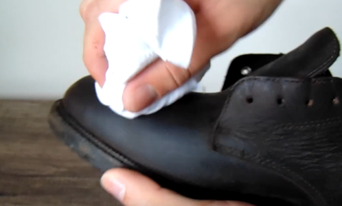

Use the polishing cloth, adding very small amount of water and polish if necessary, to turn our coat of polish into a shining surface. Work in small areas using a circular motion to bring out a smooth and even shine.

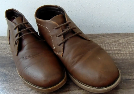

Step 7: Final Product
This is how our shoe looks compared to the other original shoe.
