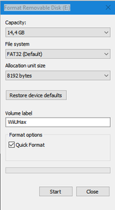

You'll need to format your SD card, and the data on the card will be lost. If you want the data, back it up.
So, you'll need to format the SD card with the settings on the picture/these settings:
- File System: FAT32
- Allocation unit size: (maximum)
- Volume Label: WiiUHax
We are half ready with the SD card!
