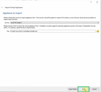

  1. First, you have to click "File" in Oracle VM VirtualBox's navigation bar. Click on it and then select "Import Appliance" and it will open "Import Virtual Appliance". You can also use ctrl + I to open "Import Virtual Appliance" Window.

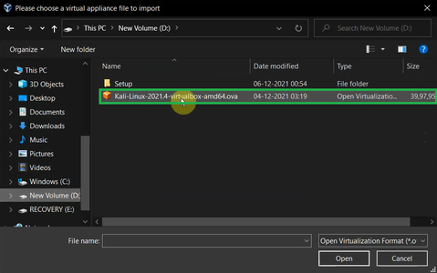

  2. Click on File icon and select and open the Kali-Linux-2021.4-virtualbox-amd64.ova file which we downloaded earlier and then select "Next" button.

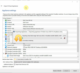

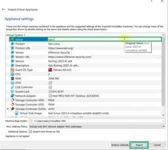

  3. A window named "Appliance settings" is opened now. You can change the name of the OS according to your own desire by double clicking on the name section. After renaming the OS, click "Import" button and this will start installing process of Kali Linux. This might take some 14-20 minutes (may vary).

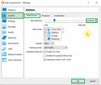

  1. Click on "Settings" icon on navigation bar in right side, then go to "System" section and then to "Motherboard" section and reset the "Base Memory" to 1024 MB and press "OK" to save.

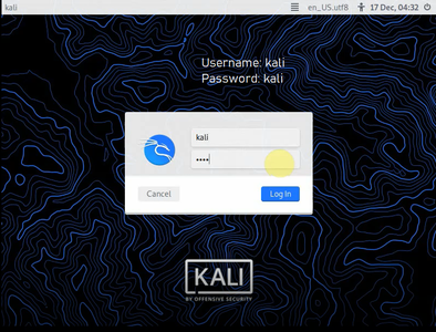

  5. The Username and Password is kali initially which you can change later on.
