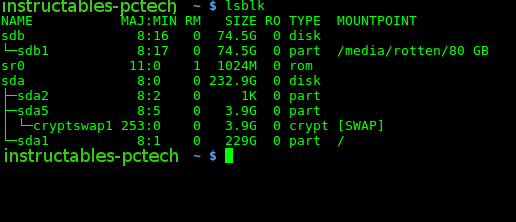

1. Open the terminal (Ctrl+Alt+T)
2. Find your hard drive letter, run the command lsblk. (Make sure you are not looking at your computer's hard drive! Usually it's sda)
3. Make sure that your hard drive is unmounted. You can do this using the file manager or use the umount command:
sudo umount /dev/sdX -l
Note: Replace the letter X with your drive letter.
4. Time to format your drive. Run the following command, replacing the sdX with your drive letter. (This will ERASE ANY DATA that is on your hard drive!)
sudo dd if=/dev/zero of=/dev/sdX bs=10M
Please keep in mind that this process may take some time, up to hours depending on the size of your drive. Please be patient. Once the process is complete, move on to the next step.

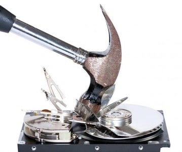

By all intents and purposes your data is unlikely to ever be recovered by now. If you plan to resale the hard drive, it should be safe to do so now. However, if you really want to permanently remove any chance of the drive ever being usable again, it's time to bring out the hammer.
WEAR SAFETY GLASSES!
If you wish to continue, it's time to bring out that old screw driver set. Most hard drives use torx bits, so you may need a special screwdriver to open them, or you may be able to use a regular flat head screwdriver. Hey, this thing's supposed to be junk so why not experiment with it a bit? Just get the thing open. If you want a guide to opening these, check out Open a Harddrive, Without Using the Proper Tools. (Thanks chinnerz!)
Once inside, you will see a shiny disk with little arms over it. These are the guts of your hard drive. Take your screwdriver and undo any visible screws, removing the assembly as best as you can. You can be aggressive with this thing if you want to.
Once your shiny disks are out, take that hammer and lay the disks on some concrete and go to work. Beat every square inch of both sides until it is warped and scratched, then fold the platters in half using your hammer. Keep in mind that unlike the movies, most modern hard drives are made out of an aluminium-like alloy and ceramic so if you were expecting this thing to shatter like a mirror, sorry. Ain't gonna happen.
Keep beating this thing until you are sufficiently satisfied, then bury it in the back yard in a 6 foot deep hole and fill it in with reinforced concrete.
(On review, I find the last sentence to be a bit overly dramatic, let the reader use discernment.)
No chance anyone's ever gonna get your data now!
