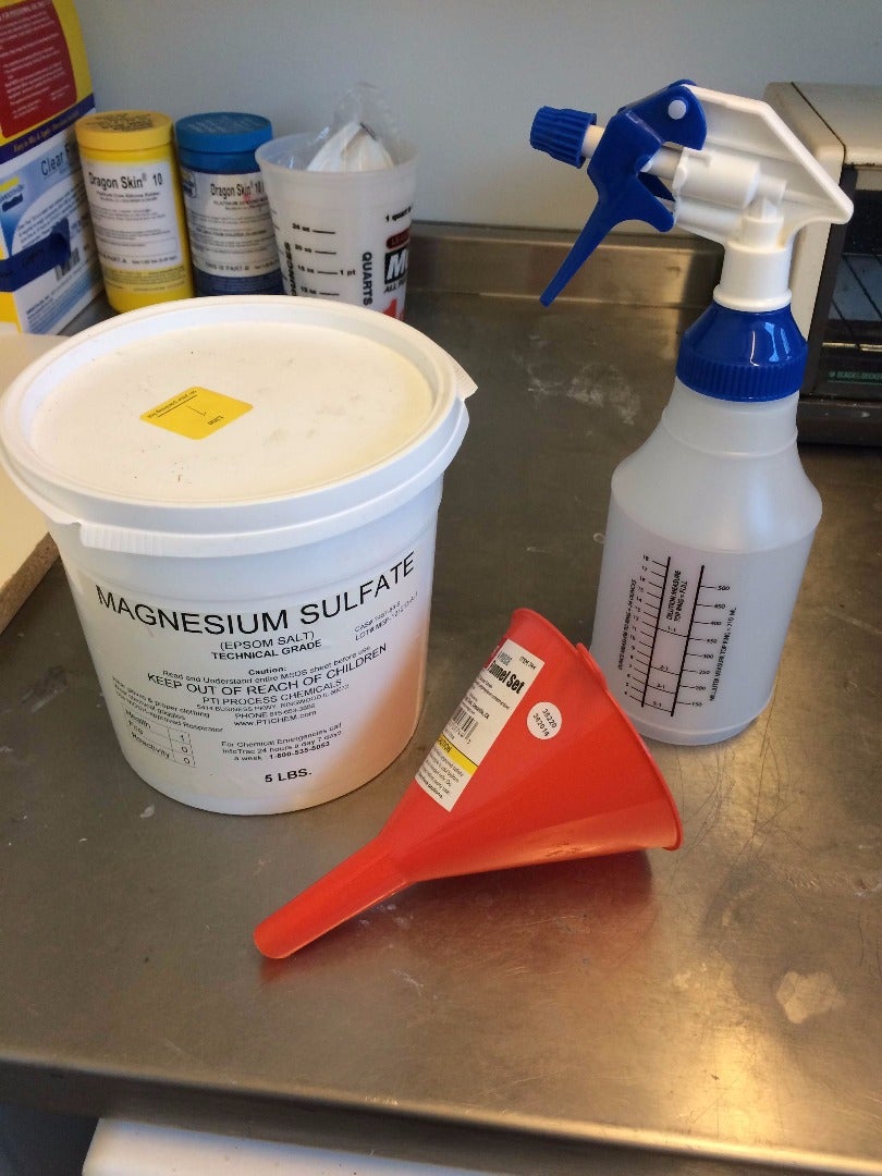

For this Instructible you will need:
A Z-Corp powder print (the print used in this Instructible is about 4.25" x 5.5" x 5.5" and is 2mm thick)
Epsom Salt (magnesium sulfate, 4 fluid oz)
Spray bottle (at least 12 fluid oz)
Wax or butcher paper for surfaces
Funnel
Goggles & gloves
A suitable area for spraying salt. Do not underestimate how much salt will get on the surfaces around your model! I used the Pier 9 Spraybooth.
Step 1: Mix the Salt Solution
The 3D Systems recipe calls for much more solution than I knew I would need. I mixed half as much salt solution as suggested.
Using a funnel and wearing goggles and gloves:
Fill the spray bottle with salt to the 4oz line,
Add warm water to the 8oz line, then
Shake the bottle until the salt is dissolved and you don't see any salt crystals. This will take a while, be patient.
