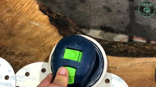

Step 1: Sanding Mode and Speed

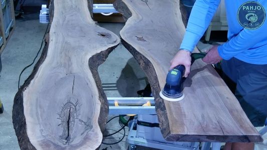

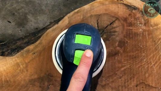

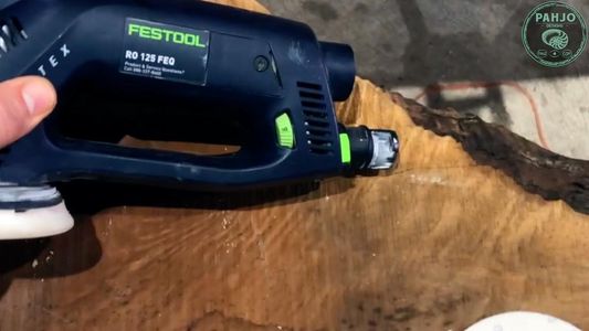

First, I place my rotex 125 in rotary mode on the highest speed setting with the black sanding pad that came with the sander.
My sander has rotary and random orbit mode. Rotary mode is a more aggressive setting for the quick removal of stock. Random orbit mode is a less aggressive sanding mode. More to come on random orbit mode...

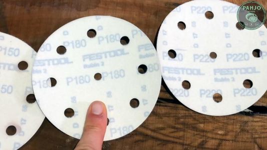

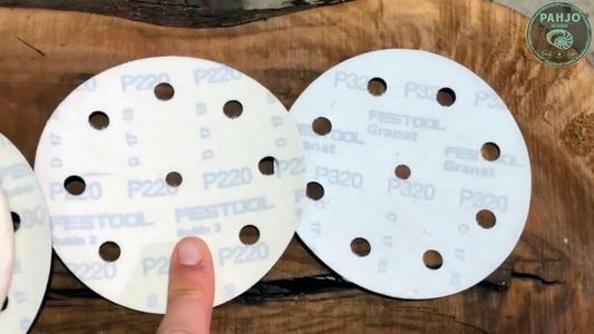

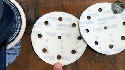

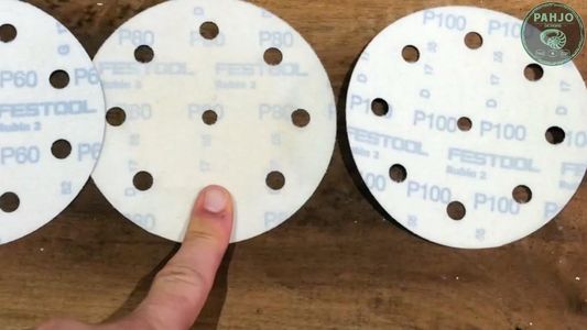

Step 2: Sandpaper Grit Sequence

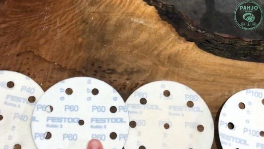

While the sander does the majority of the heavy lifting, there is a grit sequence combined with a sanding mode and a proper technique.
Sanding grits play a vital role in the sanding process. 150 grit sandpaper is the only grit you can skip, but all the others are mandatory.
The sanding mode along with my grit sequence are as follows. I explain this more in later steps.
  1. In Rotary Mode
  2. 40 grit
  3. 60 grit
  4. 80 grit
  5. 100 grit
  6. 120 grit

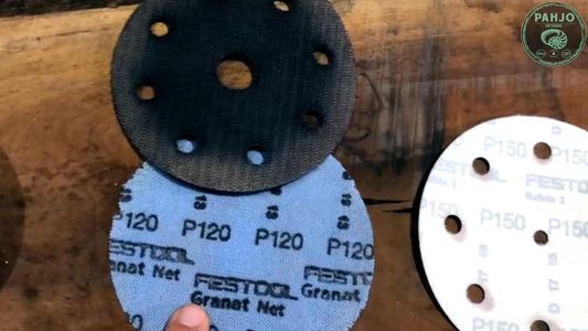

  7. In Random Orbit Mode
  8. 120 grit
  9. 150 grit
  10. 180 grit
  11. 220 grit
  12. 320 grit
Also, I use the highest speed setting throughout the entire process for hardwoods. The only time I reduce the speed is for polishing or when sanding soft woods.

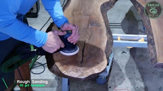

Step 3: Prepare the Surface

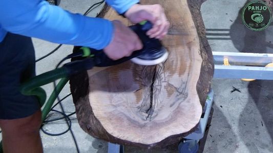

Start sander in rotary mode with 40-grit sandpaper to remove debris and expose the wood grain.

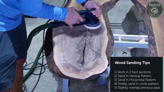

Work in 2’x2’ sections for control and to spot mistakes early.
Step 4: Sanding Technique
Use this sanding technique for each sandpaper grit.
First, sand across the grain overlapping each pass by 1/3 (about 33%). This removes rough spots.
Next, sand with the grain overlapping by 1/3. This smooths the surface.
Then, sand in 8” circular patterns to blend the previous passes and eliminate scratches.

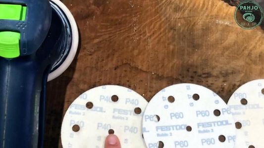

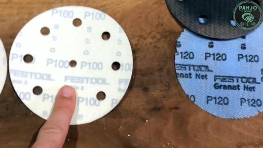

Step 5: 40 Grit Through 120 Grit
Move to the next grit (60, 80, 100, 120) and repeat the three-motion technique for each.
Don’t skip grits, as this causes scratches that higher grits can’t remove.

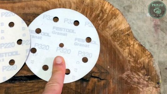

Step 6: 120 Grit Through 320 Grit
Switch the sander to random orbit mode and sand with 120 grit again using the same technique.. Then, 150, 180, 220, and 320 grit.

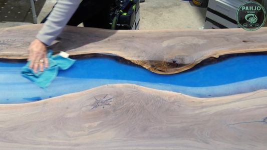

Step 7: Raise the Grain
After 320-grit, wipe the wood with a damp rag to raise the grain.
Let it dry, then lightly sand again with 320-grit for an ultra-smooth finish.
