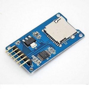

  • SD Card module + SD card to store data

  • Connect SD card Module pin GND to Arduino pin GND
  • Connect SD card Module pin VCC to Arduino pin 5V
  • Connect SD card Module pin SCK to Arduino digital pin 13
  • Connect SD card Module pin MISO to Arduino digital pin 12
  • Connect SD card Module pin MOSI to Arduino digital pin 11
  • Connect SD card Module pin CS to Arduino digital pin 10

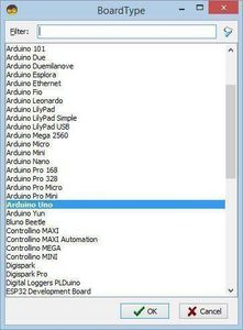

Step 4: Start Visuino, and Select the Arduino UNO Board Type
Start Visuino as shown in the first picture Click on the "Tools" button on the Arduino component (Picture 1) in Visuino When the dialog appears, select "Arduino UNO" as shown on Picture 2

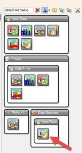

Step 5: In Visuino Add Components
  • Add "Clock Generator" component
  • Add "Date/Time Value" component

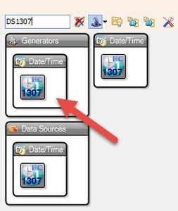

  • Add "Real Time Clock DS1307" component
  • Add "DHT11" component
  • Add "Formatted Text" component

  • Select "DateTimeValue1" and in the properties window select "Value" and set your current Date & Time

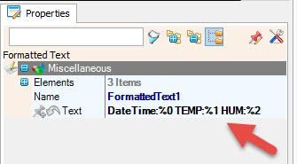

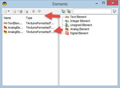

  • Double click on the "FormattedText1" and in the "Elements" window drag "Text Element" & 2X "Analog Element" to the left side.
  • Close the "Elements Window"
  • Select "FormattedText1" and in the "properties window select "Text" and type DateTime:%0 TEMP:%1 HUM:%2

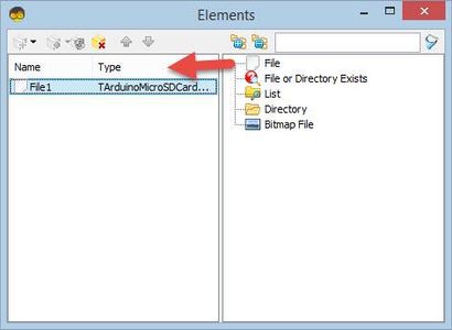

  • Double click on the "SDCard1" and in the "Elements" window drag "File" to the left side.and in the properties window select "Path Name" and type SENSDATA.txt

  • Connect "DateTimeValue1" pin [Out] to "RealTimeClock1" pin [Set]

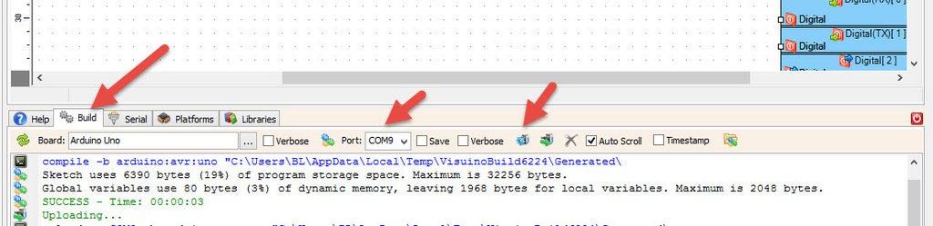

Step 8: Generate, Compile, and Upload the Arduino Code
In Visuino, at the bottom click on the "Build" Tab, make sure the correct port is selected, then click on the "Compile/Build and Upload" button.
