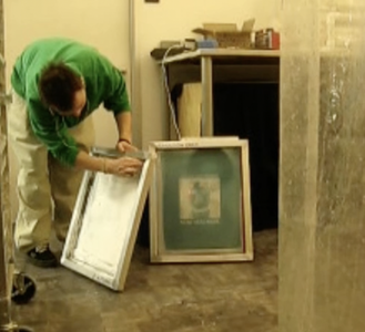

  1. To begin after you have obtained all of your materials you are going to grab your emulsion, scoop coater, and your screen.
  2. Screen print emulsion is a photosensitive chemical which means it is susceptible to light and will harden when it is exposed to it. So to prevent this work in a dimly lit space without taking many breaks.
  3. Give your emulsion a good mix before pouring it into your scoop coater. You want to have a good amount of emulsion so that it can easily coat your screen but is not overflowing out of the scooper. Let the liquid set before applying so that you can have an even pull.
  4. Then with the thinner side of your coater apply it to the back side of the screen. At around a 45 degree angle drag the scoop firmly to the top. Apply pressure as you reach the top then let the emulsion fall back into the trough and repeat this step on the other side of the screen. I do this four times before moving on and placing my screen in the dark room.
  5. I place my wet screen in the dark room with a fan to let it dry. This process will take about twenty minutes and while it is drying you can clean up.
  6. If you don't have access to a proper dark room any closet will do fine or you can even make your own. A simple dark room is a large box and a towel over it, it can really be any place that has very minimal light while the screen dries.
  7. Make sure to put any extra emulsion from your scooper back into the container, seal it and put it back where it belongs. If this is your first time storing emulsions you should keep it in a well regulated room. The liquid can last a long time as long as it's out of sunlight and not in a room that becomes too warm or cold.
  8. Lastly, wash out your scoop coater completely, and make sure that no leftover emulsion is left.

  6. Next, I take my prints to my work table, cut them out and by this time my screen should be dry and I am ready to burn. For this process, you will need an exposure unit which can be any form of light source. When you are exposing how much time you allow the screen to get and how strong the light is can drastically change your print result. Over-exposing will cause no emulsion to wash out and under-exposing will cause all of it to wash out. Its very normal for you to not get this on your first go, it took me a couple times to understand my exposure time but once you get it you'll have the ability to burn any sized screen.
  7. I am using four 50-watt light bulbs under one sheet of glass at exactly four minutes and twenty seconds.
  8. Before exposing make sure to tape your designs to the back of your screen. A very important part of this step is that when you tap your designs make sure they are backward on the back of the screen. Doing this will print them right side up when the process is done.
  9. In the video you can see I use a piece of foam to cover the top of my screen while it is exposed, this is to ensure that no light escapes the top and the screen is completely lit.
  10. Once your timer for four minutes, twenty seconds is up, quickly bring the screen over to your washout station and gently spray the front and back with a hose. After, you can let it soak for a moment. While this is happening you should be able to see a glimpse of your graphic come through the emulsion.
  11. Now you can turn up the pressure on your hose and blow out any loose emulsion on the screen. Once you've gotten rid of any unexposed emulsion your print should be perfect and you can move on to printing once the screen has dried.
  12. Place your screen next to the fan one more time and go get your printing materials.

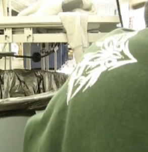

  7. Once you feel confident with your print then you are ready to put a shirt under the screen and begin. A good rule of thumb is that your logo distance from the neck opening should be about four fingers long.
  8. The best technique I can give you for printing is that your squeegee should be at almost a 90 degree angle. You need to use a lot of pressure to embed the ink into the shirt and that energy comes from your fingertips. Don't be scared to pull hard, you want to bring the ink towards you and really get it into the shirt.
  9. Two methods of printing are pushing and pulling. These are equally great and you can see me utilize both to make sure I got an equal amount of ink into my hoodie.
  10. Once you've made a successful print and you flood your screen then you can take your time to hit your wet ink with a heat gun until the ink is fully dry. Then you are done and you have successfully completed your first screen print the only thing left to do is clean up.
