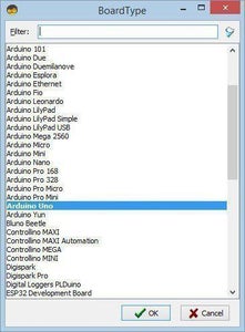

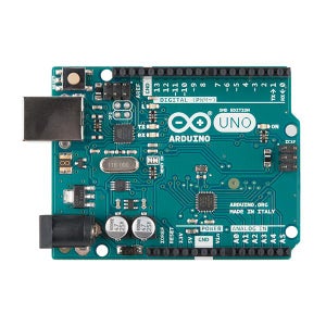

Step 2: Start Visuino, and Select the Arduino UNO Board Type

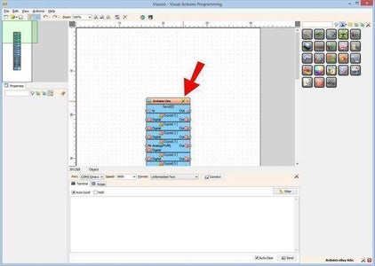

The Visuino: https://www.visuino.eu needs to be installed. Start Visuino as shown in the first picture Click on the "Tools" button on the Arduino component (Picture 1) in Visuino When the dialog appears, select "Arduino UNO" as shown on Picture 2

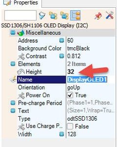

- Select "DisplayOLED1" and in the properties window set "Height" to 32

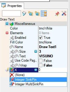

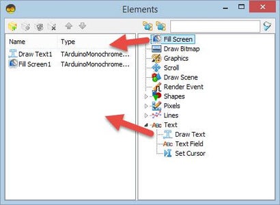

- Double click on the "DisplayOLED1" and in the Elements window drag "Draw Text" to the left, in the properties window set Size to 3, Text to VISUINO, Y to 10, select X and click on the Pin icon and select Integer SinkPin
- In the Elements window Drag "Fill Screen" to the left
- Close Elements window

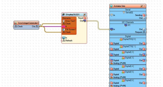

Step 4: In Visuino Connect Components
- Connect "SineIntegerGenerator1" pin Out to "DisplayOLED1>DrawText1" pin X
- Connect "SineIntegerGenerator1" pin Out to "DisplayOLED1>DrawText1" pin Clock
- Connect "SineIntegerGenerator1" pin Out to "DisplayOLED1>Fill Screen1" pin Clock

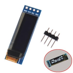

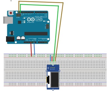

Step 7: The Circuit
- Connect OLED Display pin [VCC]to arduino pin [5V]
- Connect OLED Display pin [GND]to arduino pin [GND]
- Connect OLED Display pin [SCL]to arduino pin [SCL]
- Connect OLED Display pin [SDA]to arduino pin [SDA]
