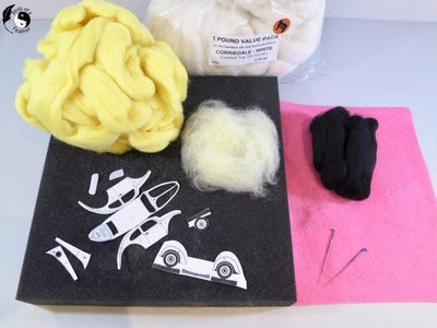

Besides the stress reduction that naturally comes from poking a felting needle in and out of a mound of wool thousands of times, I love that one can easily stop and return to this project at any time. My needle felted VW Beetle is a LOOOONG project. But for anyone ambitious enough to give this a go and work along with me, there’s a 2-hour video tutorial right above. If you go to the actual YouTube page, the steps are time stamped so you can easily click the link and pick up right where you left off!
Wool roving: Corriedale lemon yellow, white (top), licorice, grey and cherry red
38 gauge needle felting needle. I used a triangle style but would suggest playing with a variety of styles like this deluxe felting needle set. It will give you a good selection of speciality needles to try! See 'Step 2' for more information on needle types and sculpting with needles.
Dense foam felting pad
Thrifted wool sweater
Blunt darning needle

Step 4: Print the Pattern and Cut Out
I started this project on a cold winter night. Hubs had gone to bed and I was snuggled up in a brown blanket by the warmth of the fireplace. Instead of reading, I suddenly had the urge to craft.
As a trained fashion designer, I’m no stranger to taking 2-D patterns and making them into 3-D objects. For the needle felted VW Beetle, I’m using the same principles. Print out the first page of the paper pattern (you'll find the free pattern here), then cut it out and pin it onto the sweater. There's a little bit of seam allowance along the side hoods to line up the overlapping the pieces. You may find it helpful to mark this line with marker (as shown in the last picture).
Cut the sweater out, but hold onto your paper pattern because it's going to be used to help sculpt the other layers of the beetle too.

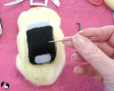

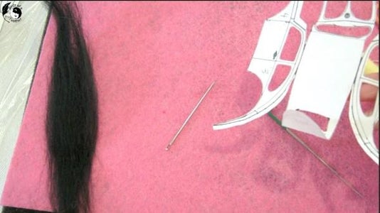

Step 9: Roof (20:47 on Video)

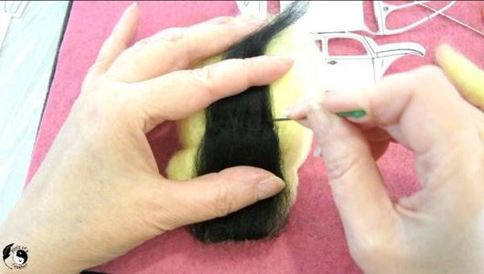

Break off a piece of black roving roughly the same width, but longer than the length of the roof. Tip: I’m working on the left side of the felting pad so I don’t accidentally cross-contaminate my yellow and black colours.
Place the pattern on the wool roving and 'draw' a line across at the front and back - above the windows - by stabbing the needle into the felt pad repeatedly. Remove the pattern and carefully lift the wool off the pad. Then fold one edge over and lightly needle felt that area together.
Apply the roving to the front of the roof over where the window will go on the body of the car. Needle felt along the line you previous drew on the roof. Flip it up and you’ll see you have a clean line in the front (last pic). Tack the other end to the back and then lightly felt through the middle of the roof. Leave the exterior edges for now because we’ll be adding more along the sides later.
Step 10: Windows (13:02 and 33:13 on Video)
The smaller pattern pieces like the windows are a little fiddly, but I use the same technique as the body of the car to shape the windows. First, stab around the perimeter into the felting pad.
Remove the pattern, then fold all the edges in. Lift the piece off the foam and continue felting with the needle to further solidify the shape.
Then use the negative space of the pattern. Pin the window shapes into the paper pattern on the car body, as shown (3rd & 4th pics), and tack them right in place at the corners. Using the negative space in this way, the pattern takes the guesswork out of placement!
Remove the pattern and finish felting the windows onto the car body completely.

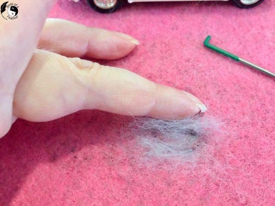

Step 11: Fixing Inconsistent Work (42:10 on Video)
If you accidentally over felt a piece and it's too small, sometimes you can use a blunt darning needle to reposition the wool where you want it and re-felt it in place. You can also use the blunt needle to help fan out the roving, like on the roof (2nd pic). See time stamp 42:10 on the video to see that in action.
If that doesn't work and the piece is still too small, just add in more felt where it's needed using the pattern as a guide.

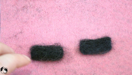

Step 15: Door Runners (1:14:54 on Video)
Use the pattern to roughly form two black rectangles. Bring all the edges in until they are neat and tidy.
See the comparison of the 3rd and 4th pictures. Keep felting until the runners are fairly compact, but still bigger than the pattern. We'll use the excess on one edge to attach it to the car.
Put the runner face down onto the door of the car as shown in the 2nd-last pic. Felt it onto the car along the bottom edge, then flip it down. Felt from the edge into the body of the car so it sits correctly in place.
Attach the short edges of the door runners by needle felting through the bumpers to hold it in position.
