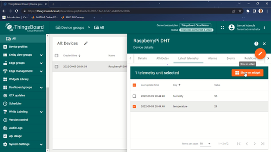

To create and view the data that are being sent in a dashboard, open the thingsboard tab again in your web browser, click on the device created and navigate to the Latest Telemetry tab. Here the latest telemetries sent from your Raspberry pi will be displayed (Not that only the last value will be shown).
Click on the temperature telemetry and click on the show on the widget.

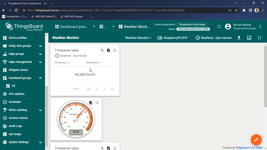

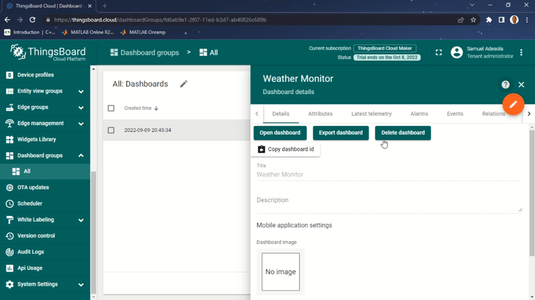

From the card drop-down option, select your chosen widget type and click on add to the dashboard. Now we don’t have a previous dashboard created so click on Create new dashboard, give it a name and click on Add. You can create as many widgets card as you want, repeat the same step for the humidity telemetry and you will have your dashboard created. (Note that while creating the second widget, just select the dashboard you created instead of creating another one) To view your dashboard, select Dashboard groups in the left pane, and you will have the All dashboard group, open it and you will see the dashboard you created
Click on the device and click on Open Dashboard.
