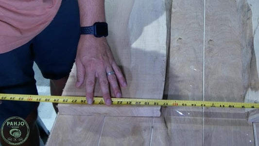

First, I determine the volume in cubic inches by measuring the length, width, and height of the resin area.
Quick Tip: If the width of the area varies, take a measurement every 6 inches and average the numbers.

For example, the area of my project is 47” long, 10” wide, and 1.5” high. So, the volume in cubic inches is 705.

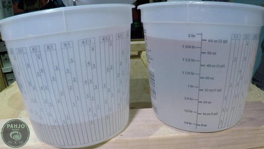

I used deep pour epoxy for this project which requires a 2:1 mixing ratio.
In turn, I mixed 128 ounces of part A and 64 ounces of part B.

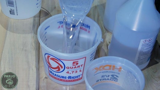

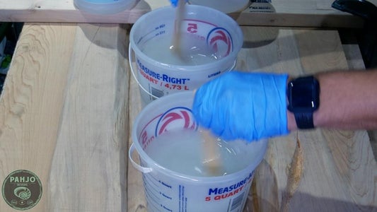

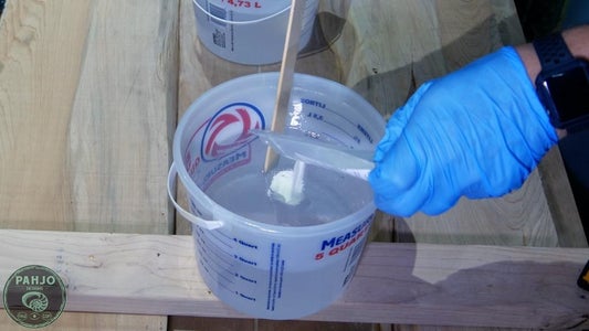

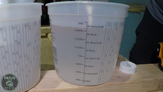

Step 4: Mix Epoxy
As a quick tip, use 3 containers when mixing epoxy resin for accurate measurements and proper mixing.
In fact, most epoxy resin manufacturers recommend it.
I use each container for a different purpose when mixing epoxy resin.
  1. First Container: Part A
  2. Second Container: Part B
  3. Third Container: Mix Part A and Part B.
My 5-gallon buckets were being used for a different project, so I used 6 small containers (2 groups of 3).
Most epoxy looks cloudy at first. However, it turns clear when properly mixed and ready to use.
Optional Step: Next, I added 4 ounces of glow powder to each 96 ounce container. I use this step in the process to mix any additive to the epoxy such as pigment powder, dye, or glow powder.
I thoroughly mixed the epoxy with a stir stick.

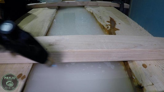

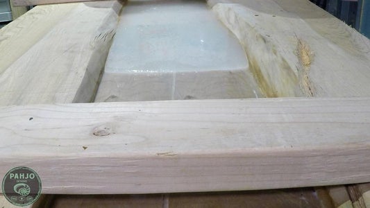

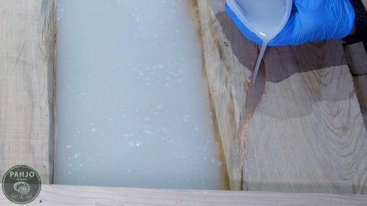

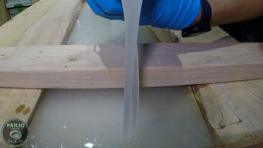

Step 5: Pour Base Layer
I poured the epoxy into the area and checked for leaks. Next, I removed the bubbles with a mini torch.

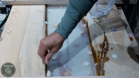

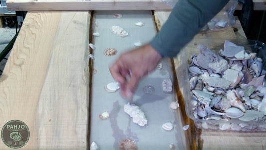

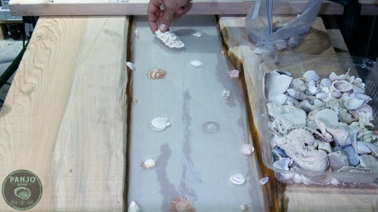

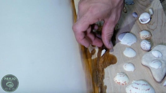

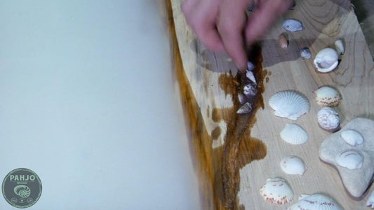

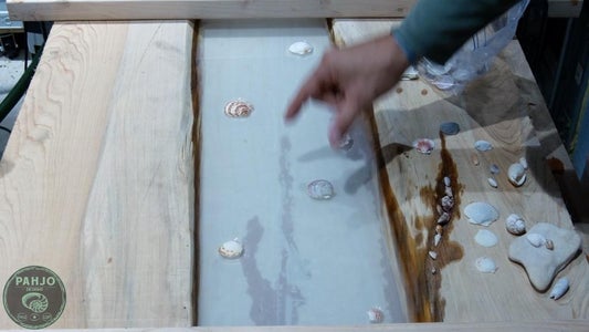

Step 7: Set Shells in Resin
I chose the shells from my collection to set in resin. Next, I placed the shells in the resin in a random pattern to resemble a beach or ocean shore.
Once I placed the shells in the resin, they sank a small amount. Then, I allowed the epoxy to cure a bit more before casting the shells in resin

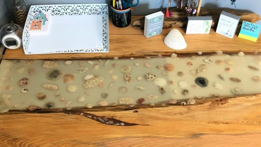

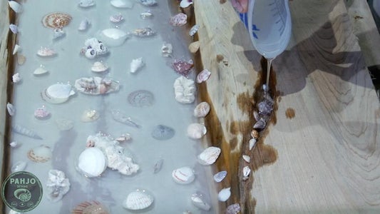

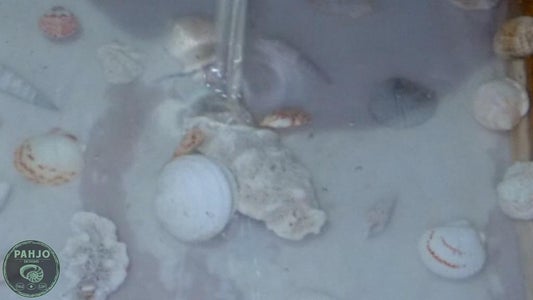

Step 9: Epoxy Casting Coat
First, I mixed the second half of resin (192 ounces) and poured the epoxy over the shells very slowly. I find I create air pockets if I pour the epoxy too quickly when embedding seashells.
I monitored the epoxy for 30 minutes to remove any air bubbles with my mini torch.
