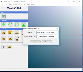

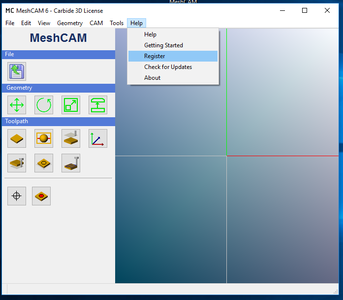

MeshCAM: http://www.grzsoftware.com/ Download MeshCAM and install. Open it up go to Help > Register > Enter your Registered Name and Code > Register!

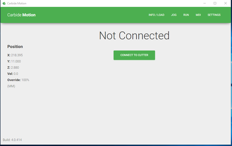

CarbideMotion: https://carbide3d.com/downloads/ Download, install. This one is free and does not require registering or licensing.
The above programs give you control of your milling machine and of rendering the drawings
Step 6: Finishing Touch
Connect all the wires to their appropriate connections, Turn on Nomad 833, run CarbideMotion and voila! you have yourself a connected machine to a laptop
