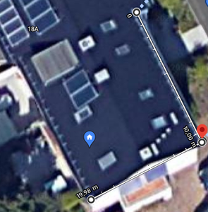

As the first step, go to a website like google maps and search your house or flat. Than measure the area of your roof where you can "take" the water from. Pay attention to the scale! Than take a look at the average rainfall per year in your town. Now think about how big your barrel should be. That for, you take a look at the average rainfall per day of all rainy days. Than you convert the number of mm into litres. For example: For a roof of 50m² with an average rainfall per rainy day of 10mm, you can calculate it like this:
10mm ≙ 10l/1m²
10l * 50m² = 500l
Attention! You can mostly only use half of the width of your roof, because otherwise you need 2 rain barrels for each side.
