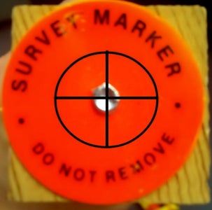

Step 2: Establish a New Temporary Benchmark.
Within our projects we typically need to establish a new point of reference with a temporary benchmark.
Using a small nail tapped into the center of a wooden stake, pound the stake into, and as flush as possible, with the ground.

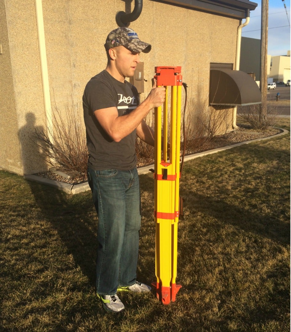

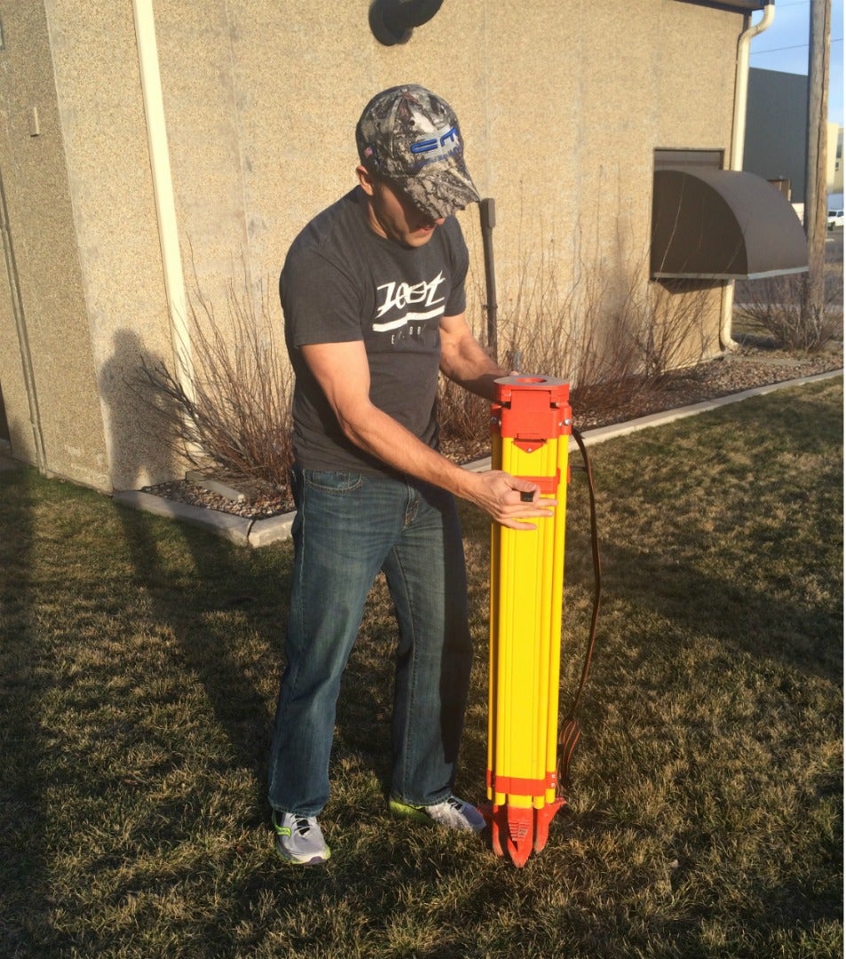

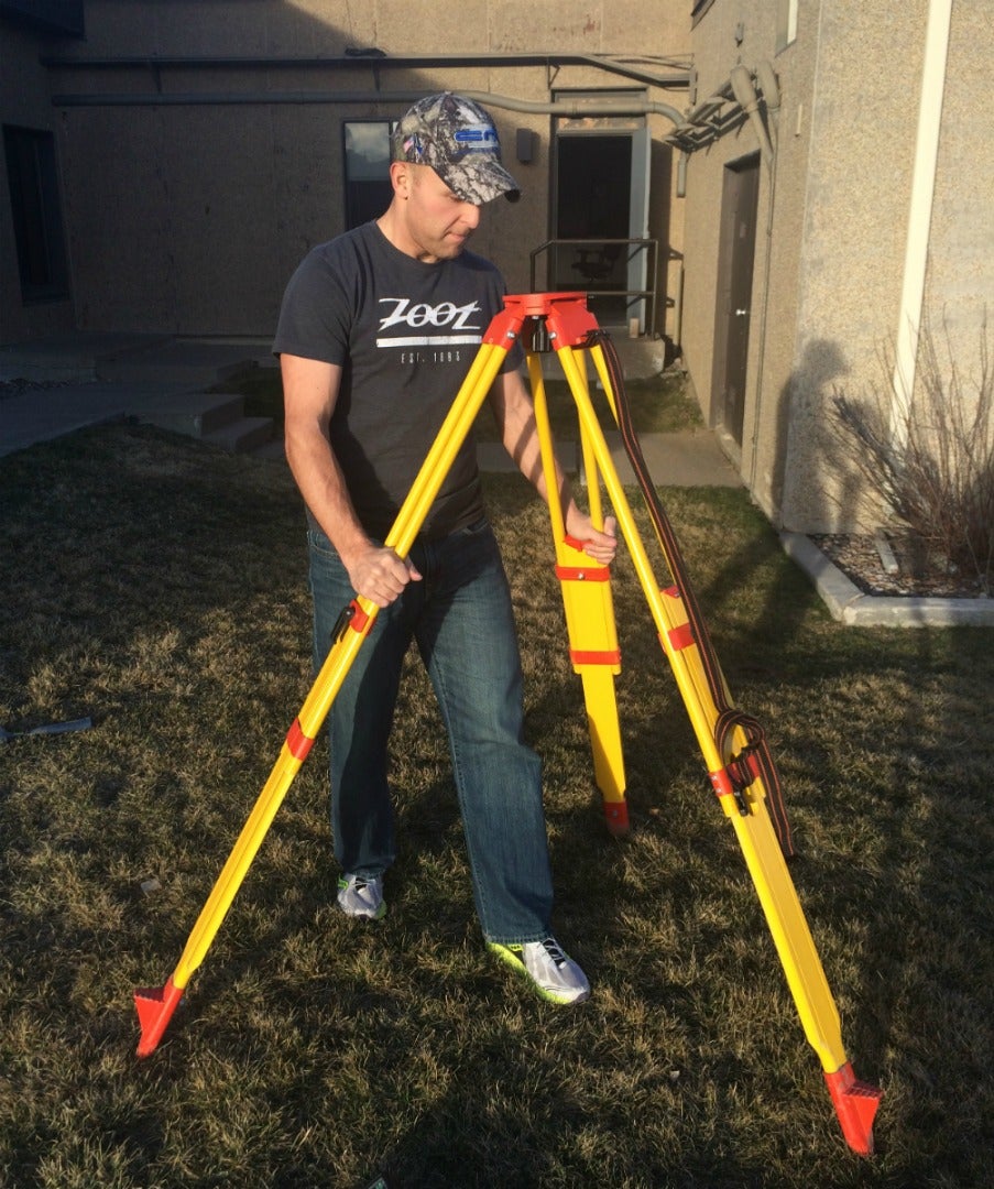

Step 3: Set-up the Tripod.
While holding the tripod, loosen the tripod leg clamps and extend the tripod up to a height near your neck and chin. Tighten the leg clamps.
Spread out the tripod legs evenly, about two to three feet for each leg, and center it over your benchmark stake. The top of your tri-pod should be mostly level and parallel with a horizontal plane.

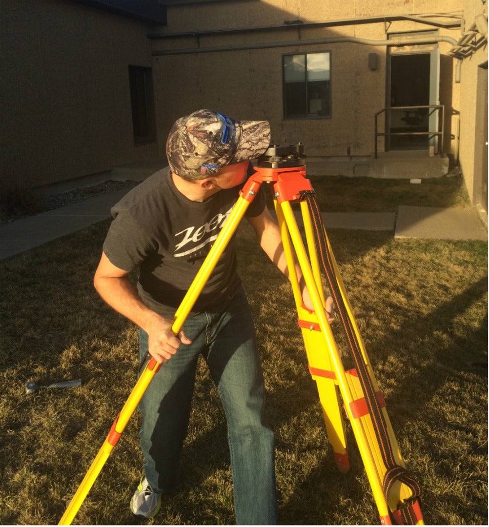

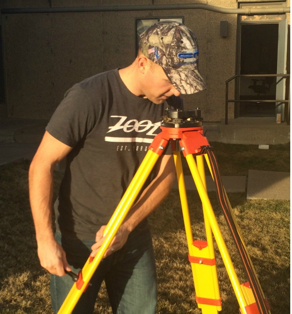

Step 4: Attach the Tribrach and Coarse Level the Tripod Over the Benchmark.
A level instrument is a key to successful surveys. The tribrach features a level bubble and leveling screws to adjust the tripod’s level as necessary. An optical plummet on the tribrach allows the surveyor to view the tribrach’s center and place its cross-hairs precisely over the survey marker nail on the stake.
Center the tribrach on the tripod and attach it via the tripod connecting screw.
While holding two tripod legs, keeping the tripod as level as possible, place the optical plummet cross-hairs over the center of the nail.

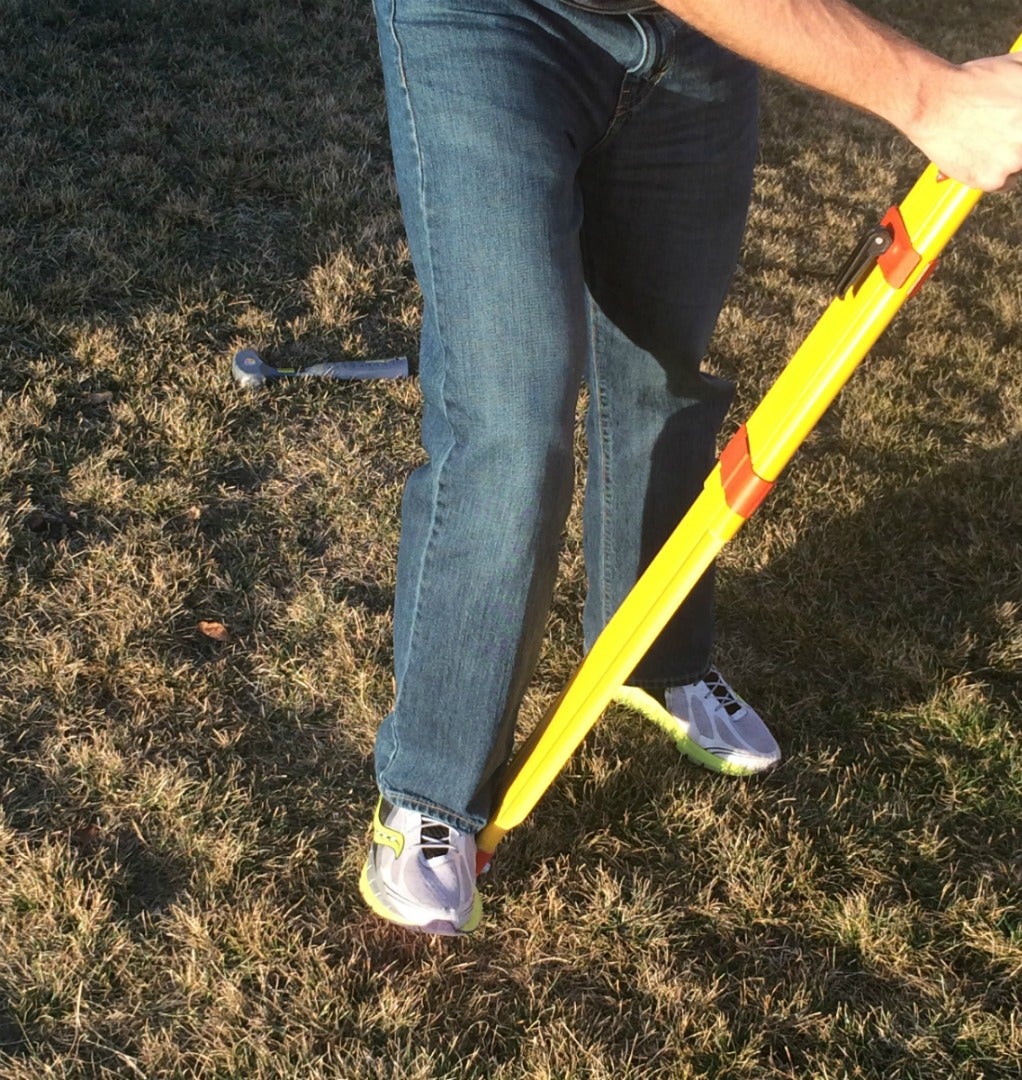

With your foot, apply equal pressure along each tripod leg to ensure a stable connection with the ground.
Step 5: Continue to Level and Adjust the Tribrach As Necessary
Viewing the level bubble, adjust the height of two tripod legs so that the bubble is close to center. Then use the tribrach leveling screws for a more precise bubble level.
Alternate back-and-forth between the optical plummet and level bubble to gain the most center and level position. You may need to loosen the center tripod screw to shift the tribrach for a more center cross-hair position.

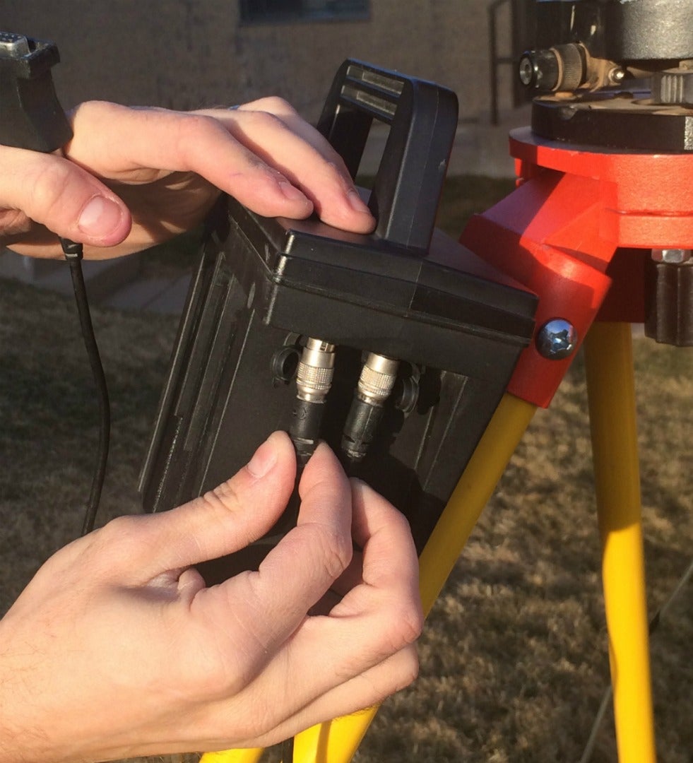

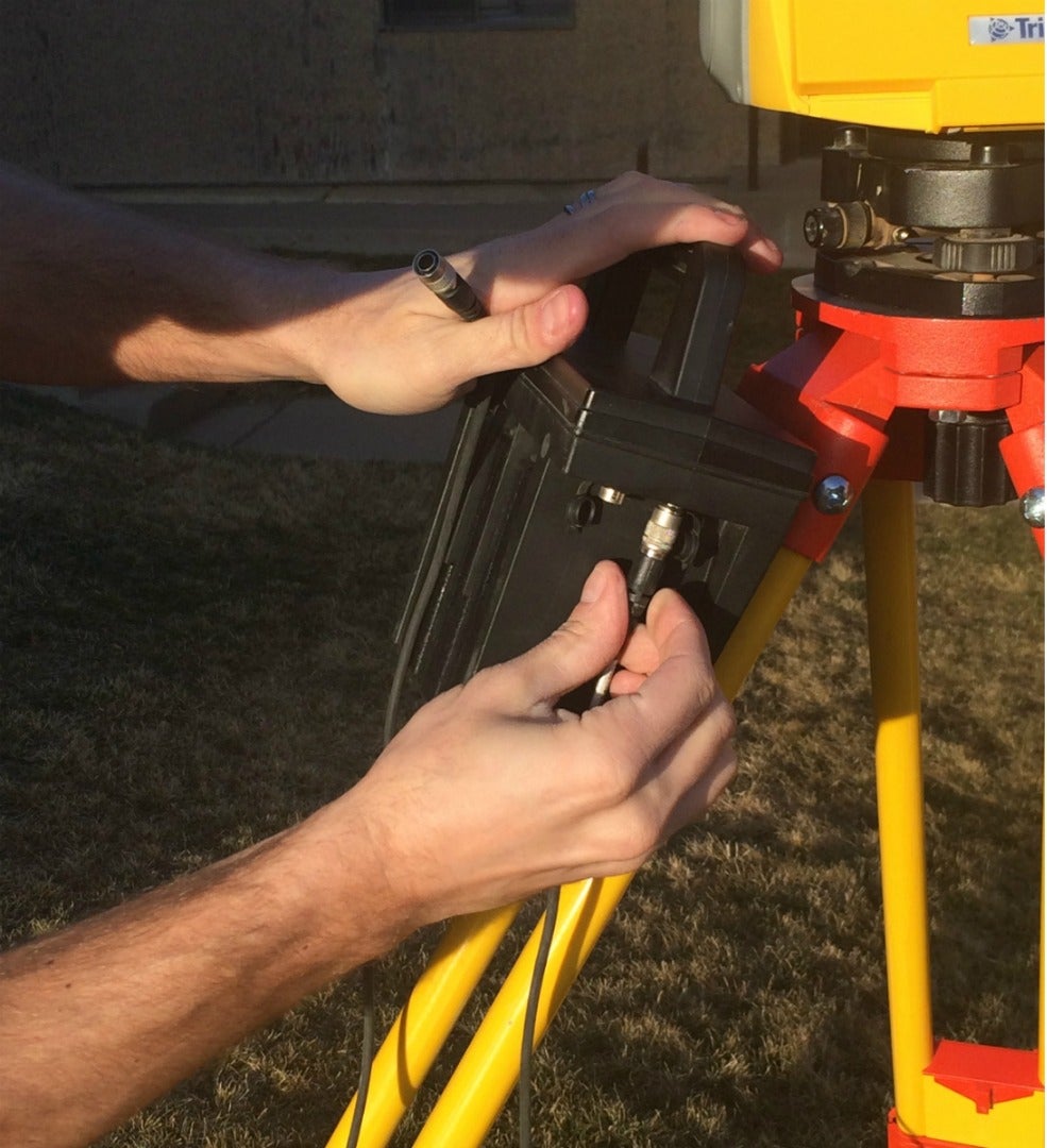

Step 7: Connect Power Supply and Communication Cables.
Attach the battery pack to the tripod.
Connect one cable from the battery pack to the instrument connection port.
Connect the other cable from the battery to the survey controller.

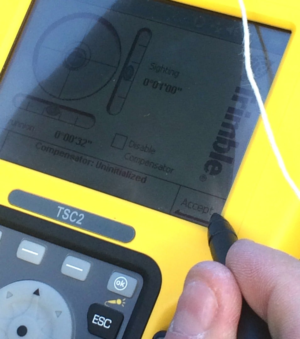

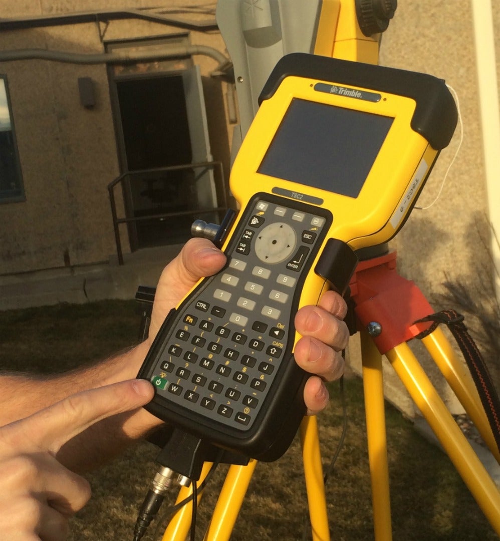

Step 8: Power-on the Instrument and Controller to Access the Fine Level.
Press the black button on the instrument to power it on.
Press the green button on the survey controller to power it on.
On the survey controller, use the stylus to open the survey controller program. The software will open fine-leveling automatically.
Step 9: Fine Level the Instrument and Compensate.
To fine level the instrument, turn the total station so that its face-plate is parallel with two tribrach leveling screws. These two screws will be used to adjust the trunnion (left and right) and the sighting (forward and back).
Now that the instrument has been successfully leveled, press the accept button so that the instrument can perform its compensation action.
