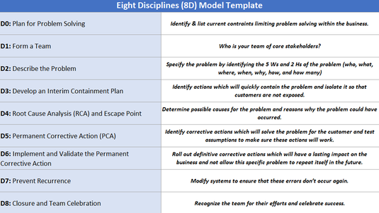

Step 1: D0 – Prepare for the 8D Process:
Define the scope and set clear objectives for the problem
Step 2: D1 – Establish the Team
Select a cross-functional team with the right mix of skills and expertise
Step 3: D2 – Describe the Problem
Document a clear and measurable problem statement with supporting data
Step 4: D3 – Develop Interim Containment Actions (ICA)
Implement temporary measures to prevent the problem from affecting customers while a permanent solution is developed.

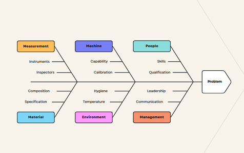

Step 5: D4 – Determine, Identify, and Verify Root Causes
Use tools like the 5 Whys or Fishbone Diagram to analyze and identify the root causes.
Step 6: D5 – Choose and Verify Permanent Corrective Actions (PCAs)
Select the best corrective actions and verify their potential effectiveness.
Step 7: D6 – Implement and Validate PCAs
Put the corrective actions into practice and monitor their effectiveness over time
Step 8: D7 – Prevent Recurrence
Modify systems, processes, and training to ensure the problem does not reoccur.
Step 9: D8 – Recognize the Team and Celebrate Success
Acknowledge the efforts of the team and document the project’s success for future reference.
