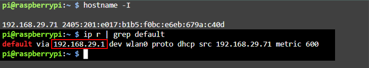

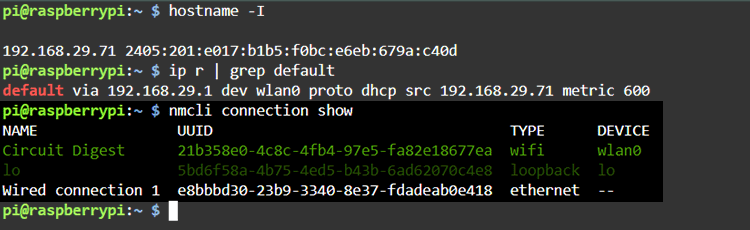

Step 1: Find Out What IP Your Pi Has Now
Open a terminal and type:
hostname -I
This gives you the current dynamic IP. Remember that, so you can avoid conflicts when you pick your static IP.
Step 2: Get Your Router’s IP Address
Run this:
ip r | grep default
It should fetch something like 192.168.1.1 or 192.168.29.1. That’s your default gateway.
Step 3: Check Your Network Connection Name
Every connection managed by NetworkManager has a name. To see yours:
nmcli connection show
Look for your active connection. Mine was "Circuit Digest" because that’s my Wi-Fi SSID. If you’re on Ethernet, it'll say something like “Wired connection 1”.

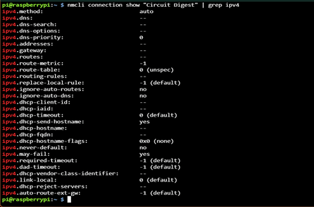

Step 4: See Your Current IP Config
This one’s not necessary but useful:
nmcli connection show "Circuit Digest" | grep ipv4
This shows how IP addresses are being assigned (probably set to auto if DHCP is still in play).

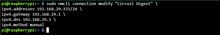

Step 5: Actually Set the Static IP
Now we get to the good part. Use the command below to assign a fixed IP. Swap in your own values if your network's different:
sudo nmcli connection modify "Circuit Digest" \
ipv4.addresses 192.168.29.155/24 \
ipv4.gateway 192.168.29.1 \
ipv4.dns 192.168.29.1 \
ipv4.method manual
Breakdown:
  1. addresses - is the IP you want to set.
  2. gateway - is your router.
  3. dns - can usually be your gateway too.
  4. method manual - tells it to stop using DHCP.

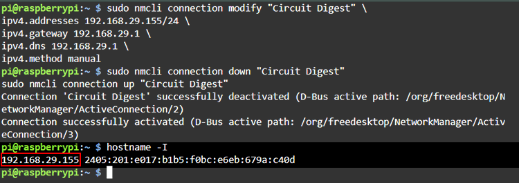

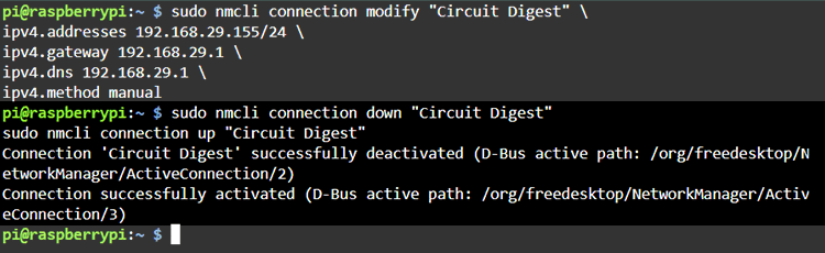

Step 6: Restart the Connection
Apply the changes by bouncing the connection:
sudo nmcli connection down "Circuit Digest"
sudo nmcli connection up "Circuit Digest"
That's it. Your Pi should now reconnect using the static IP you just set.
Step 7: Confirm It Worked
One more hostname -I and it should now show your shiny new IP (like 192.168.29.155). You can now ping, SSH, VNC, or do whatever else without your Pi ghosting you.
