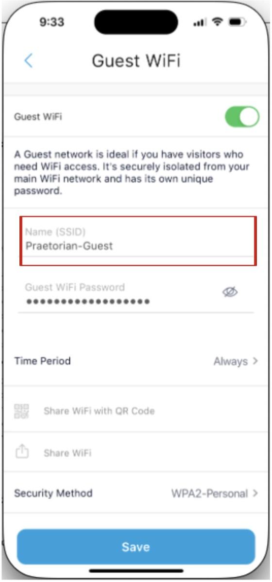

Toggle the Guest WiFi switch to turn it on.
Step 6:
Enter the name you would like to use in the Name (SSID) field. This is the name that will appear when you connect to the guest network. In this case, I used “Praetorian-Guest.”
Step 7:
Under the SSID field, there will be another field to create a Guest WiFi Password. Select a strong password, preferably with at least 10 characters (alphanumeric, upper and lowercase, and special characters).
Step 8:
Ensure that the Time Period is set to Always. This will keep the guest WiFi network available at all times.
Step 9:
Finally, select WPA2-Personal as the Security Method. Using this security protocol will protect your guest WiFi under the password that you created in step 6.
Step 10: Completion!
Click on Save at the bottom of your screen. The Orbi router usually takes a few minutes to turn on the Guest WiFi.
