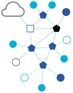

Introduction: How to Setup a OpenThread Border Router Using a NRF52840 USB Stick and Connect the Thread Sensor Tag
With this instructable I want to show you how easy it is to setup your own Open Thread Border Router at Home using a Raspberry Pi an nRF52840 USB Dongle and connecting the open source Thread Sensor Tag to measure Light, Temperature, Pressure and Humidity with ultra low power.
This will be Part one of a series of Tutorials. I will show later as well how to use the Data of the Thread Sensor Tag.

Step 4: Setup the OpenThread Network
Open your browser and enter the IP address of your Raspberry Pi like http://192.168.178.XX make sure you use the correct IP Address. If you set a host you can also type the host name.
In the OTBR GUI go to the Menu "Form" to form a new Thread Network. You can leave the fields as they are for now but Google recommends to change them and leaving the default Channel and On-Mesh Prefix values. Then press Form
