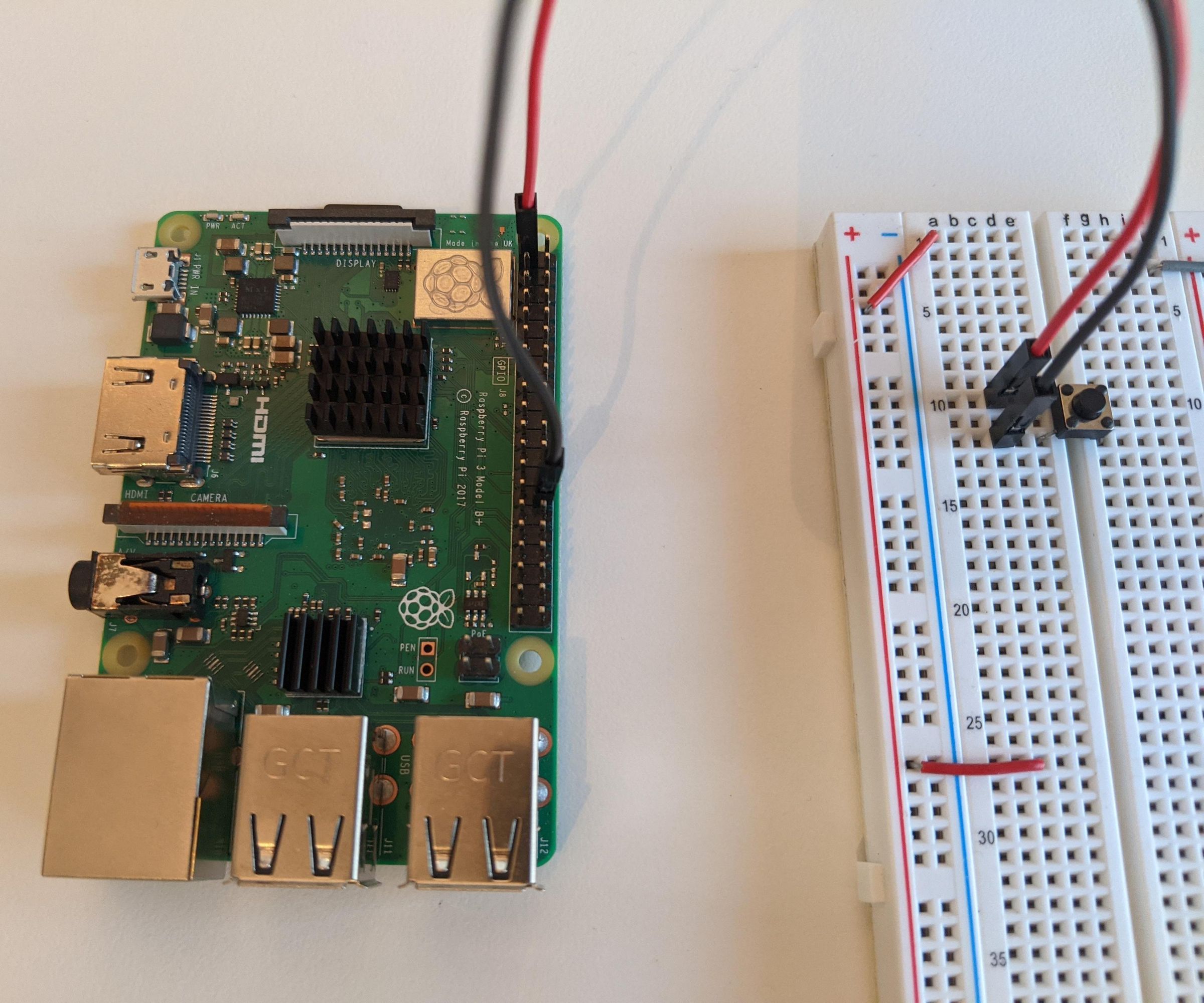

Here is where it starts to be interesting. You will need to connect a screen + mouse + keyboard to the Raspberry Pi for this step. We will see afterwards how you can access your Pi remotely from your normal computer, without having the need to connect all of those. If you are using a Raspberry Pi 4, you can use the first picture at the top of the tutorial to find out how to connect them.
