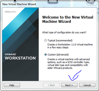

Step 2: Step 2: Set This Prompt to These Settings
After you do that click "Next."

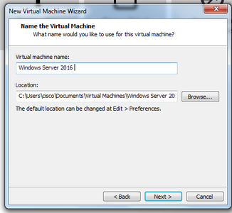

Step 6: Step 6: Give the VM a Name
I would recommend the name to be the name of the OS that you are installing.
Then click "Next."

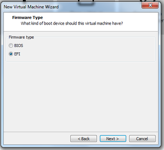

Step 7: Step 7: Pick the Firmware Type
If you have an OS that is Windows 8 and later pick EFI. Anything before that click "BIOS."
*Note: If you are not sure which one to pick, just pick "BIOS."
Then Click "Next."

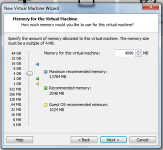

Step 9: Step 9: Give the VM Some RAM
So this step can be tricky. Most modern OSes recommend that you have at least 2-4ish GB of RAM in order to run smoothly. Also you need to leave some RAM so the "Host" (the OS installed on your PC) OS can run. Here is a "Rule-Of-Thumb" always leave 2-4 GB free of RAM, so for example if you have 4 GB of RAM in your PC give 2 GB to your VM or if you have 8+ GB of RAM then give the VM 4 GB of RAM (more if you need more performance).
*Note: If it is an older OS like Windows 98, you would use what is selected on the screen due to limitations in the OS. Also, I would not recommend you use VMs on PCs with less than 4 GB (unless it is an old OS).
Then, click "Next."

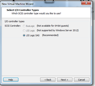

Step 10: Step 10: LEAVE THIS SETTING ALONE
This setting can be confusing to some people. IF YOU DO NOT UNDERSTAND ANY OF THIS DO NOT CHANGE THIS SETTING. It should look something like this.
Then Click "Next."

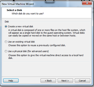

Step 11: Step 11: Use the Recommended Setting
You screen might look different than mine. Just make sure you use the setting that is Recommended.
Then Click "Next."

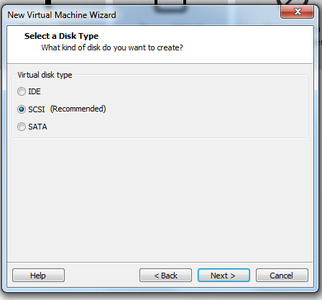

Step 12: Step 12: Pick the Disk Type
This might also be different for you. This is where you tell the "VM' what type of "Virtual Disk" to use (basically a emulated hard drive).
*Note: Modern OSes use a SATA Disk. Legacy (Old) OSes use a IDE Disk. Ignore the SCSI option (it is mainly for server OSes).

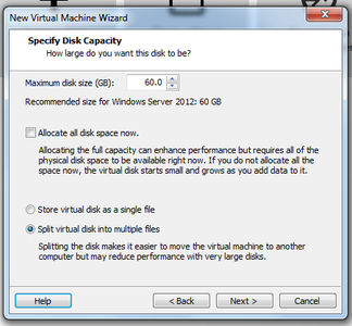

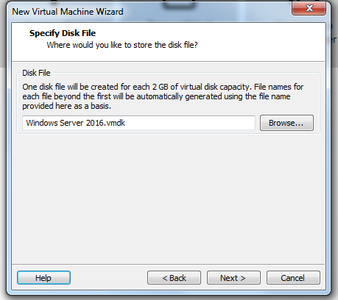

Step 15: STEP 15: Give the VM Hard Drive "Space"
This one is important to set up. If you are going to install anything 7 or later I would recommend at LEAST 30-40 GB of space. Anything older (or Non-Windows OSes) use what is recommended. Also, leave the other settings ALONE.
*Note: You will not lose the the disk space yet if you leave the "Allocate all disk space now" box unchecked, but instead you will lose space as the Virtual Drive fills up. For example: This VM can have up to 60 GB of space, but when I first install the OS it should only use about 25-30 GB of space (this will vary for different OSes) and as if it fills up to 60 GB, then you lose all the space.
Then Click "Next.
