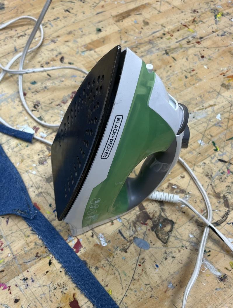

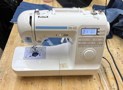

Tools:
  1. Sewing machine
  2. Clothing Iron
  3. Pins
  4. Scissors
  5. Flexible measuring tape
  6. Pen/fabric marker

Step 5: Stitching the Hems
Stitch along the hem line with your sewing machine. You can use any stitch setting that your machine has, but a simple single stitch, usually the most basic setting on your machine (Setting #1) will work nicely for this whole project.

Step 14: Sewing the Straps
Fold strap width in half (in direction of ‘hotdog bun’ fold!). Press folded strap with heat iron to make stitching cleaner without the use of pins. Stitch along edge with sewing machine. Leave smaller seam allowance or trim off excess after stitching. Repeat for the other strap.

TIP: Run the heat iron over piece to create a flatter and sharper look if your fabric has been wrinkled throughout your making process.
