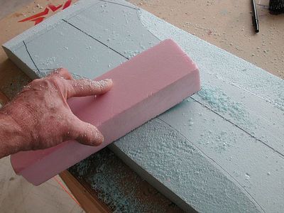

Step 3: Sand Smooth
Now it’s time to sand using your flat sanding block.
Sand only cross ways across the mold, (90 degrees to the length of the deck) to keep the planes flat.
Again, do not sand below the template lines on either side of the mold. This will ensure a flat and straight profile.
Remember to check with your straight edge frequently to ensure you are making flat planes.
Finish your surformed concaves by sanding to the line and no more. It is easy to go too far. Both sides of the mold should look the same
Here is the finished mold with nose, tail and concaves shaped uniformly. You can still see the drawn template lines.
