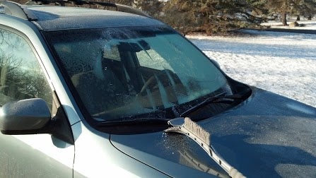

Regardless, over the years, I had grown rather fond of a particular window ice scraper, due to its design which included both a brush and a second handle to accommodate two-handed scraping (a must in the dead-of-winter Michigan mornings, due to the fact that my garage stores far too many tools and projects to ever consider using it for parking cars). However, this November, I had noticed that the blade had become nicked and dull, rendering the tool rather ineffective in removing frost from my windshield.

First, I attached the coarsest sandpaper to the sanding block. This is done to create a firm, flat surface to accommodate even sharpening.
Next, I started sharpening by laying the scraper blade across the sandpaper at the same angle as the bevel of the blade, and rubbed side to side, applying light to moderate pressure. I then sanded the underside of the blade, also applying light to moderate pressure. I repeated this process until the noticeable nicks were sanded away.
I repeated using the 150 grit sandpaper, then finished using the 240 grit sandpaper, until the blade felt uniformly sharp and smooth.
