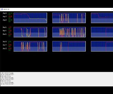

Before we get into the meat of the tutorial we will have a quick look at the result to make sure this Instructable is something you are interested in. The application is very simple. It shows the temperature in the top graph which moves much like the graphs on your computer showing CPU and Memory usage.
The graph is a free control and all you have to do to get it to show your data is tell it what value to display.
At the bottom of the application is a box which, like the Serial Monitor in the Arduino IDE, displays the output of the Serial.println() command in your Arduino Sketch. Don't worry the source code is coming and will be explained.
You can move the window around your desktop and the program continues to update in real time, there are no delays which makes this perfect for telemetries - processing and displaying live sensor data.
