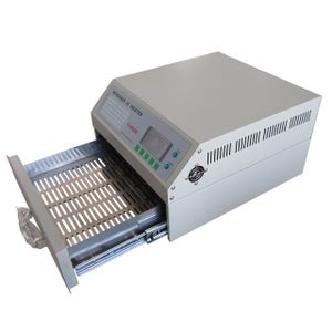

Step 5: Method #3: Using a Stencil to Apply Solder and Reflowing With an Oven
This method uses a stencil for dispensing the paste on to the PCB but for the actual heating of the board a reflow oven is used because it provides an enclosed space where temperature can be controlled precisely. You can build your own reflow oven by re-purposing an electric oven and making your own reflow oven controller. There are plenty of open source designs that you can use and they all use the same principle a PID loop A thermocouple for measuring temperature and a solid state relay for switching the oven on or off according to the program. Using such a setup you can follow a reflow profile which is usually given in the datasheet of the solder paste or the datasheet of the component. This is the same process used in industrial pcb assembly, the only difference is that they have more complicated ovens with different zones and some are filled with specific gasses instead of air to provide the best possible solder joint.
I have built my own reflow oven 7-8 years ago and I’ve used it successfully for assembly thousand of boards. However in recent years I haven’t used it because I only assemble 1-2 prototypes and I tend to use method #1 or #2 because it’s faster and more economical.
You can also buy ready made reflow ovens from China, those are decent from the reviews I’ve seen and there is even an alternative firmware for them that you can load. So if you are not on a tight budget you can also buy one of those. Not really needed for prototyping work but certainly needed if you are assembling more boards, especially if you plan to sell your boards.
